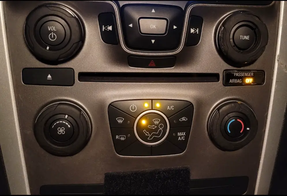

As I understand, there is a Ford update for when Explorer remote start HVAC goes to A/C after a minute or so of running....
This is interesting. Never knew this was an issue with manual climate controls. Are they knobs? I’m not familiar with what they actually look like.

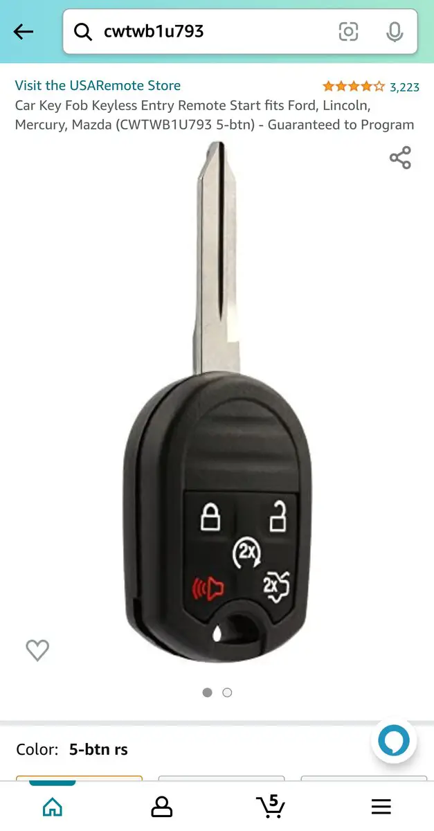

That number does not bring up any results on Ford Parts, Tasca Parts or Levittown Ford.
This is the only place I have had any luck finding it and it is not a 5 button fob. CWTWB1U793 - Google Search

This is the one remote start works for me. The problem is instead of hit lock and two times to middle button (this is from manual) mine starts with single touch to middle button trying to make it safer
Here is image of that work for me key plus it is 96 bits instead of 48 original safer for remote copy and Amazon image here $19
