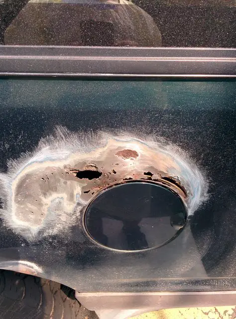

I would honestly go with what Monmix is telling you.
Even though you only see rust in that area, there is most likely more rust on that panel.
Explorer's have a tendency to rust out bad above the gas cap.. and it always starts from behind.
Just cut the whole panel off and save yourself a headache later..
Here's how bad mine got before I had to take action..
I appreciate the advice. I probably am going to go that route and remove the whole panel. I plan to keep the truck until she won't move any more, so I want it done right.

I have not cut out any panels yet but looking at 3 options. 1) I am looking at a potential donor vehicle on Sat morning (he's asking $900). 2) There is a local Pull-a-Part that has over 40 2nd gen Exploders in it now and the whole panel is ~$100 it is just I will have to figure out how to get it cut out at the junk yard. 3) The local used panel place here wants ~$350 for a cut out rear quarter panel as well. They say they will cut it wherever I ask them to.
