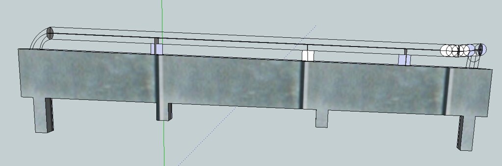

So I've got a set planned out I'm thinking 2"x2" frame mounts a 2"x8" sliders air tank and then an outer 2" tube off the side to slide against trees and serve as a step ill post some pics soon any thoughts on this setup

Rock sliders top view by billyssingle, on Flickr
With captions by billyssingle, on Flickr
Front outside view by billyssingle, on Flickr
Comments? All are welcome....
what thickness are you going with? those are going to be HEAVY even if you only use .125
Yeah that's what I'm somewhat concerned about.. the body is 8" roughly on the bottom and I really want max protection for the body....
Any suggestions?
I honestly have no experience with sliders. I built some 6 years ago and have yet to put them on the truck. seems like a small tank ideally located somewhere would be a better way to go. I think you need to ask yourself if you really think you'll get crazy enough with your truck to need that much protection.
I don't see the weight being a big deal as long as they are strong enough to use as a jacking point without bending or losing their ability to hold air.

i have actually been building exactly what you are talking about and have one of them welded up. still need to put bungs in it. i made mine out of .25 yes they are heavy but this way i am not worried about them at all.

These seem to be the best underbody protection....
Just gonna throw my .02 in here.
The "air tank" is going to have a lot of welded spots, in all directions. I am not an expert welder by any means, but I think this will weaken the steel in areas, and, these welds will be very difficult to clean and coat effectively under "rock sliding" conditions. The internal voids and corners will hold moisture, and once one little spot is compromised, then gets hit with an impact twist on the nerf bars---ummmm
It might go hiss and it might go boom.

Thought about that for sure and I'd definitely run with them at 0 and flip on compressor just before needed... Running them with no air should help reduce the added stresses...

I honestly don't think i'd worry about it all that much. Especially if you are using .25 wall tubing...even .188 wall would be plenty strong. What's an aftermarket air tank made of, 16 gauge at best? Granted you aren't bashing it against rocks and such but the worst you are gonna do with the sliders is dent or bend them if you are lucky.
That was my conclusion more or less.. plus IF and I stress IF I damaged one I have another for backup...
The key would be good airtight welds.....
