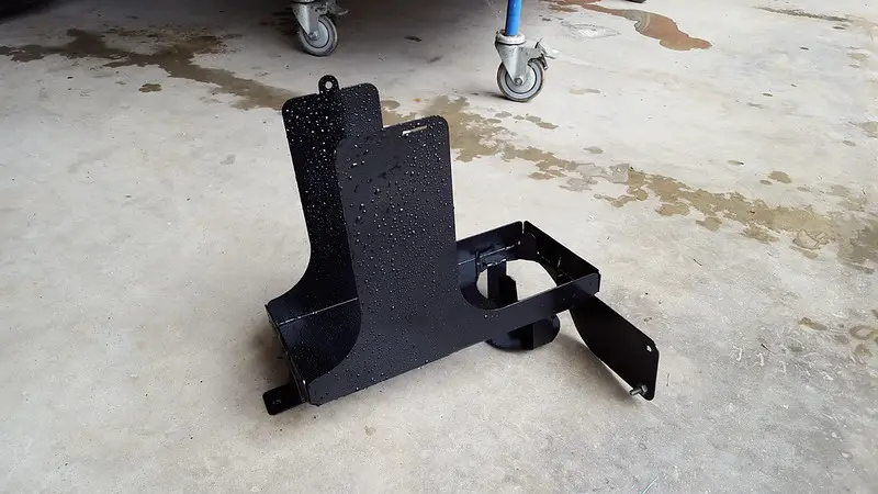

As you can see the gear oil comes out the bottom so that the top is flat to clear the hood. The gear oil is just able to sneak between the radiator shroud and the air intake tube. My rivet gun broke before I could get it assembled so I will have to install it later.

Got the oil mount painted just before the rain.

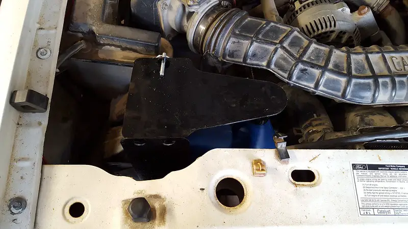

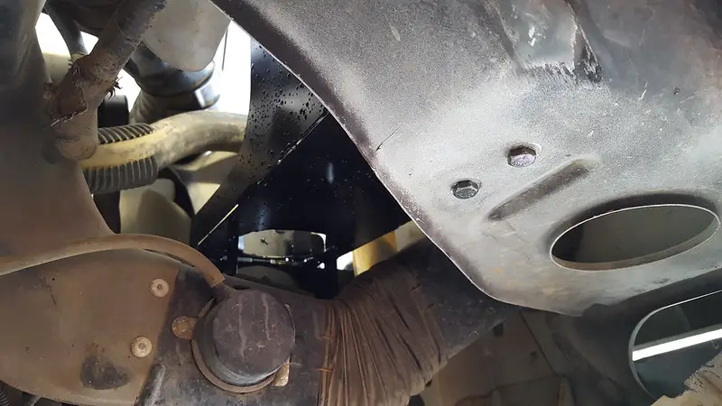

One side mounts with two 1/4" bolts thru the inner fender well. You can see where the factory air intake remain intact so I stay smog legal.

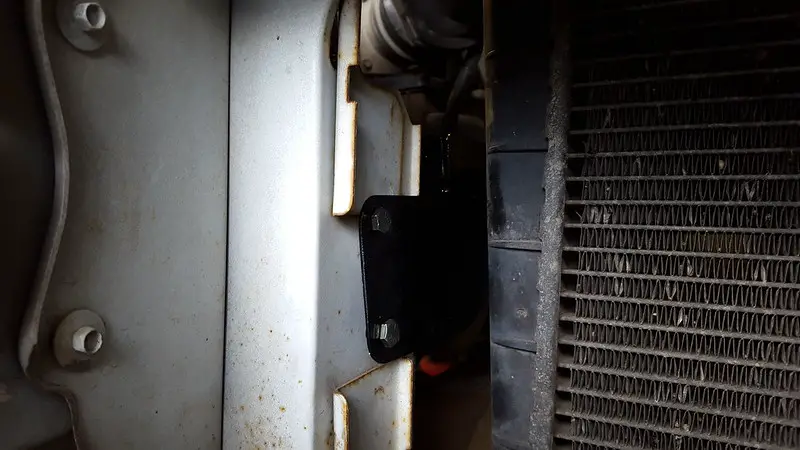

The other side mounts with two quarter inch bolts to the side of the radiator opening. It has to mount at a slight angle so the lover bolt has an extra nut mounted between the bracket and body. Gives just the angle needed to clear everything.

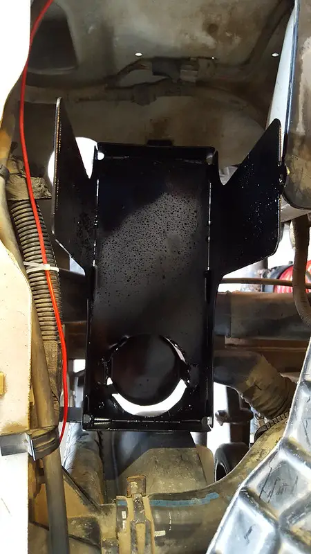

A view from the top with no bottles in it.

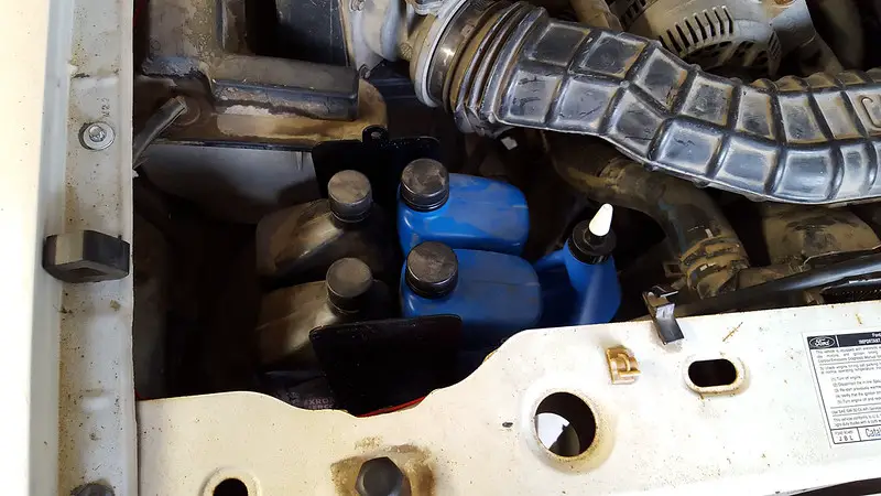

I put 2 quarts of ATF and 2 motor oil as well as one gear oil.

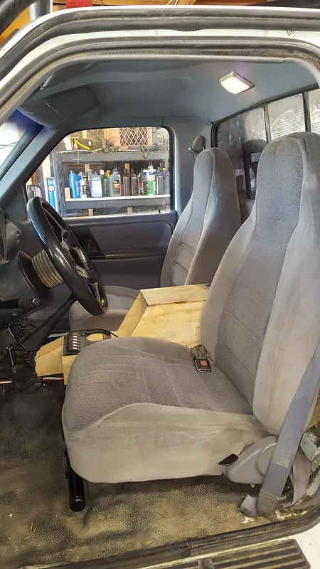

Started on my new center console. I took measurements from my old wood one and made adjustments to it. Then I drew up the pieces on the computer and cut it on my plasma table.
center by Matthew Dresselhaus, on Flickr
The pieces are tabbed with holes on each piece that after bending on the relief lines (because I still do not have a decent brake/press) allow the holes to line up and a pop rivet to be installed. The white spots in the pictures are each rivet.
20151130_175205 by Matthew Dresselhaus, on Flickr
The lid has both a latch to hold it securely closed when off road and a lock in case I want to lock valuables inside it.
20151130_190256 by Matthew Dresselhaus, on Flickr
Here it is set in the truck for a test fit. I still have a few adjustments to make then it will be ready for paint. I also am going to add an upholstery top to the lid.
20151130_191115 by Matthew Dresselhaus, on Flickr
That is over the top cool. You should clear coat it.
What is the advantage of rivets over welds? It seems like I am always grinding or drilling rivets and that sucks, so I rarely use new ones!! I suppose welds would be worse to remove.
Easy to remove is the biggest benefit over a weld. Do not need a bunch of clamps to hold it together during assembly. Other then a few bone head layout mistakes I made in the drawing the whole thing can be assembled with out the use of a tape measure. In theory when the two holes line up put a rivet in and pull. Due to my crappy brake I can't get repeatable bends. They are close but have just enough variation to sometimes cause headaches. I might go back and pull the rivets and weld it together. See how well the rivets hold up.
