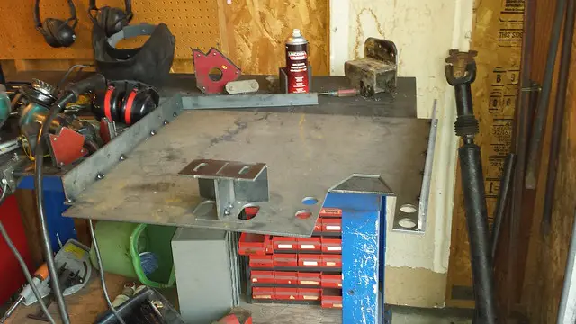

Started on the main pan of the skid plate. Got this far till I ran out of steel. Once i get more steel I'll cut the rest of the pieces and get it all welded and installed. I am thinking about putting some HDPE plastic on the the bottom of it. Does anyone know where to get it? Need a 24x29" piece.

Are you asking about a cutting board plastic? If so they sell those in virtually any size you need at any restaurant supplies store/ warehouse. Last I saw uline sold it as well. Grainger probably sells it as well. Doing a quick search shows usplastics.com and eplastics.com (this one will cut to fit any thickness.
There is a place I found at one time. Its in a thread of mine somewhere. Search cutting board under my name. I have a piece about half the size your looking for in the garage that I was going to work into a skid plate.
Most of the builds on Pirate i've seen use UHMW but the HDPE looks promising. Does it work any better or worse than UHMW? The HDPE is certainly cheaper in the same thickness and sheet size when a doing side by side comparison.
Looks like there's plenty of online suppliers but shipping might suck, maybe search for "plastics" in your area.
Found this place in Orange County...not close to you I know but at least you can get an idea of what pricing is like:
http://www.iplasticsupply.com/materials/polyethylene-hdpe-ldpe-sheet-rod/
That is the plastic I was thinking of. No idea if one is better then the other.
