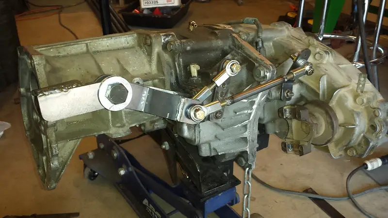

After about 10 different variations I came up with some new shifters for the Transfer cases. Still need to get a shift boot and some handles. Will see how it works when I get it on the trail.

Would you mind posting a picture or 2 of how and where you attached the levers for the transfer case and doubler? I'm assuming it's to the flat parts on the transmission end but would like to see if possible. Thanks.

Yes I just welded a rod to the flat areas. I will see if I can get a picture of it but with my skid plate it might be difficult.
