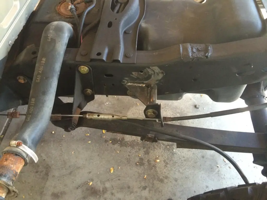

Looks like everything works really well. When I swapped the Explorer disc brake axle in my ranger I had fun getting the Ebrake to grab. It only wanted to grab on one side. I made a bracket and spaced where the cable mounts off the spring mount towards the axle about an inch and it helped take a ton of slack out. I'll see if I have an old pic of what I did, I have the truck half torn apart at the moment and it doesn't have much of an Ebrake right now.
Edit: Found a pic that mostly shows the bracket I was using.

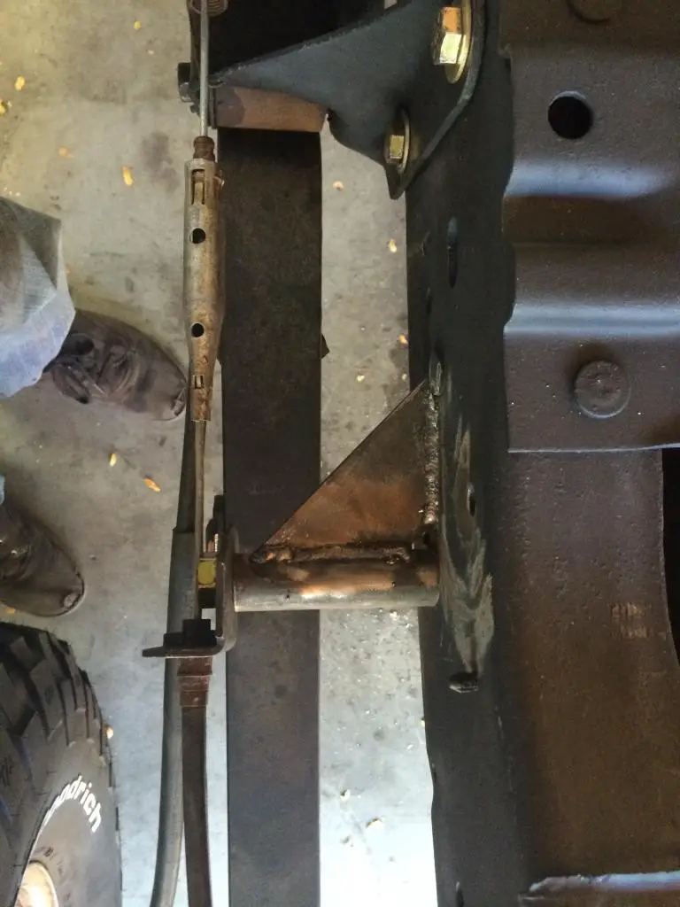

When I put the disc brakes off a 1999 Explorer on the rear axle of my Explorer, I used a turn-buckle to take up the slack. I was planning on using it as a temp fix and figuring it out later, but it worked so well its staying.
I couldn't find a picture of the turnbuckle setup, but I did find a few pics of how I mounted the brake lines to the axle;

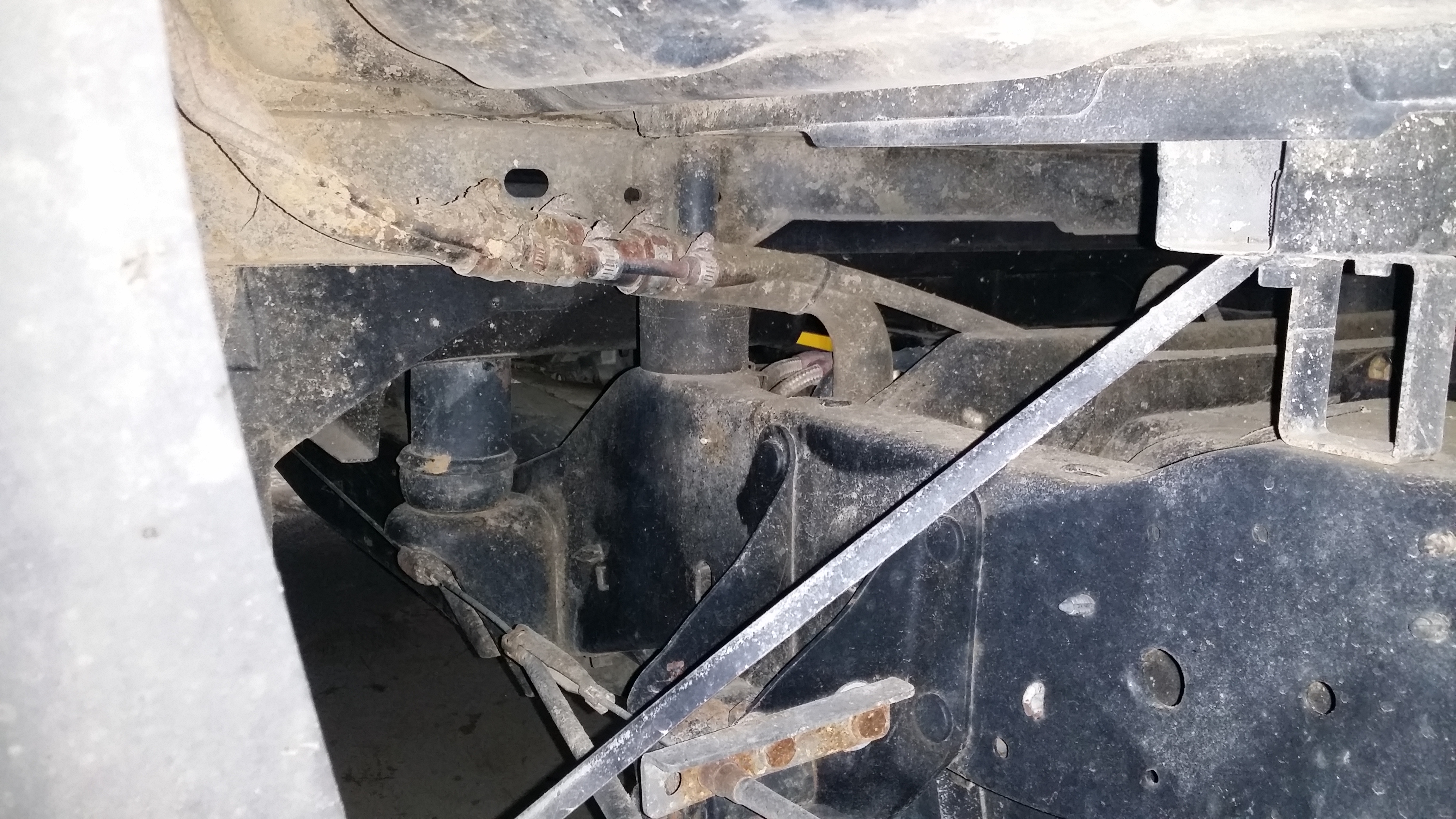

I have the SuperLift flip-kit that has been reinforced with plating and welded to the axle. The right side spring perch collapsed while on the Rubicon trail many years ago.

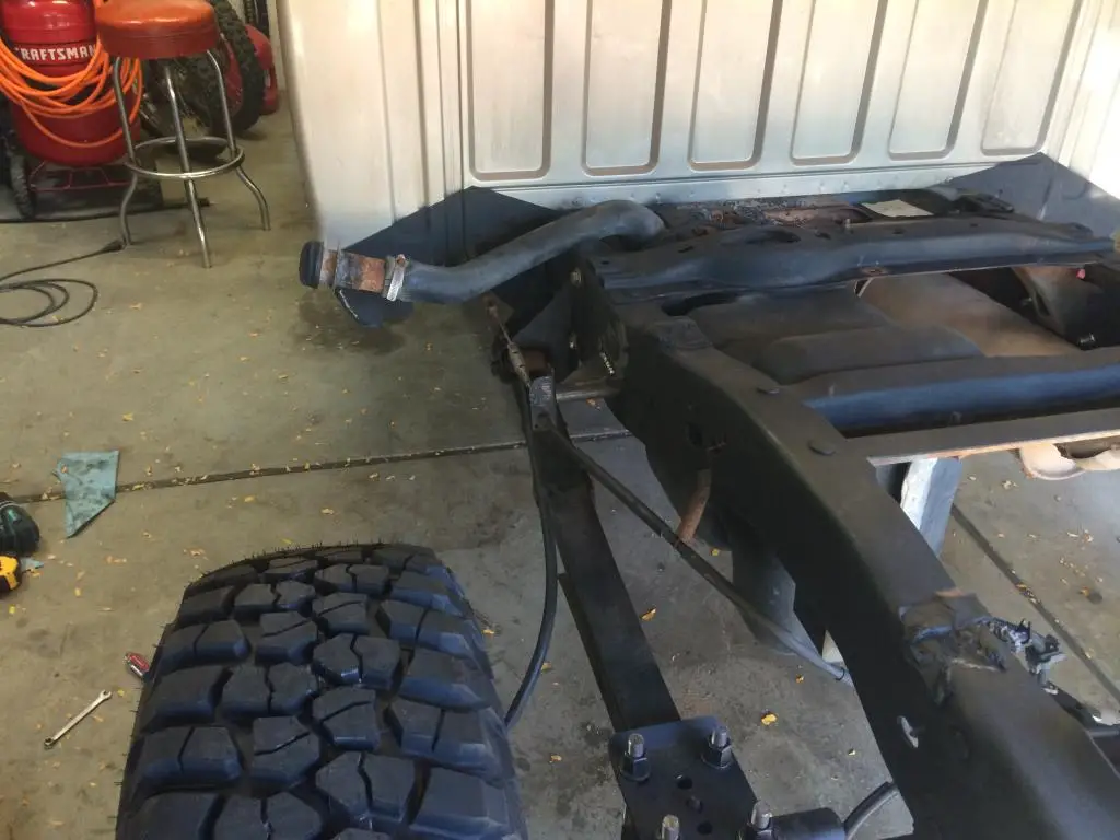

Ok I'll show mine too:
I used a non adjustable cable off a sport I believe. I made this bracket out of a stock bracket:
I adjust it with the adjusters in each drum through the little window behind the backing plate. I click the ebrake down a few clicks, then tighten the adjusters until they won't tighten anymore and the shoes are touching The drums. It works great.
I made a bracket that mounts off the leaf spring hanger and moved the mounting hole back about 6 inches. I might just need to re adjust the brakes again now that I have driven it a bit.

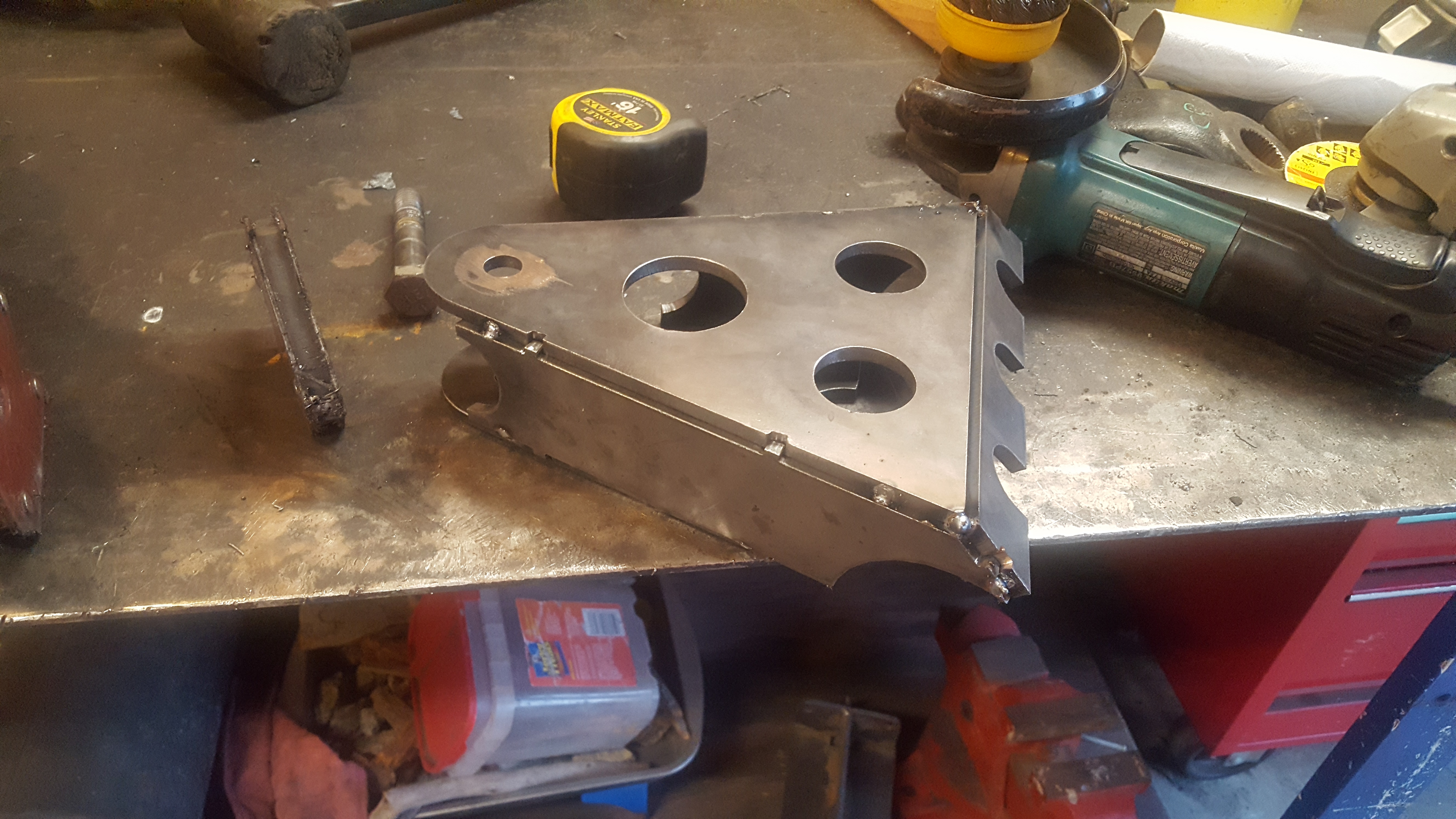

I was replacing a worn out TRE on the front end when I happened to look at the axle side trackbar mount and saw this.
20170703_140024 by Matthew Dresselhaus, on Flickr

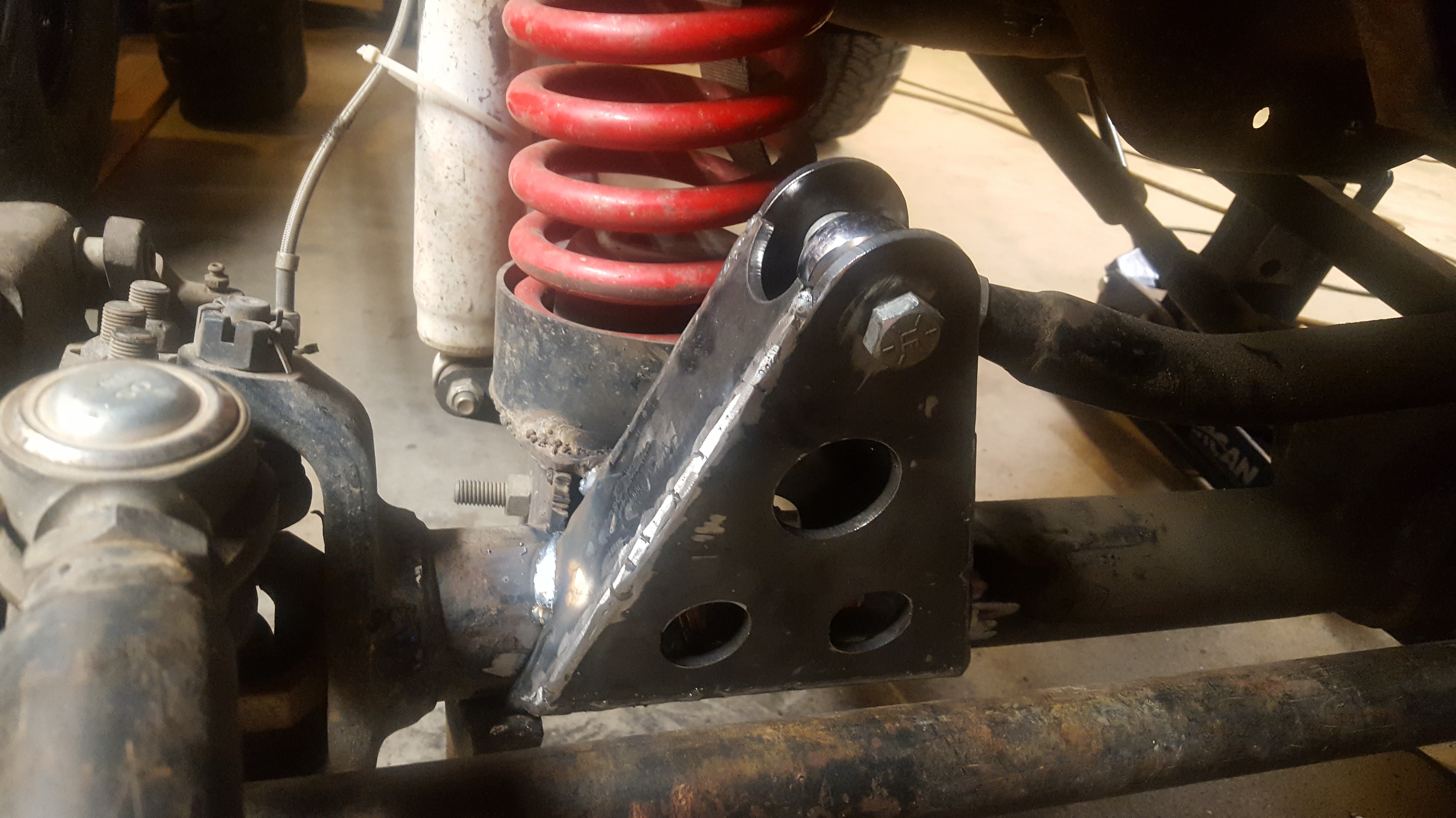

That bracket is about 6 years old with about 10k miles on it. It is the only bought bracket I have used on the truck. So I started designing up a new bracket to replace the failing one.
bracket2 by Matthew Dresselhaus, on Flickr
Dude! I have that same one on my truck! I am going to go check it right away
