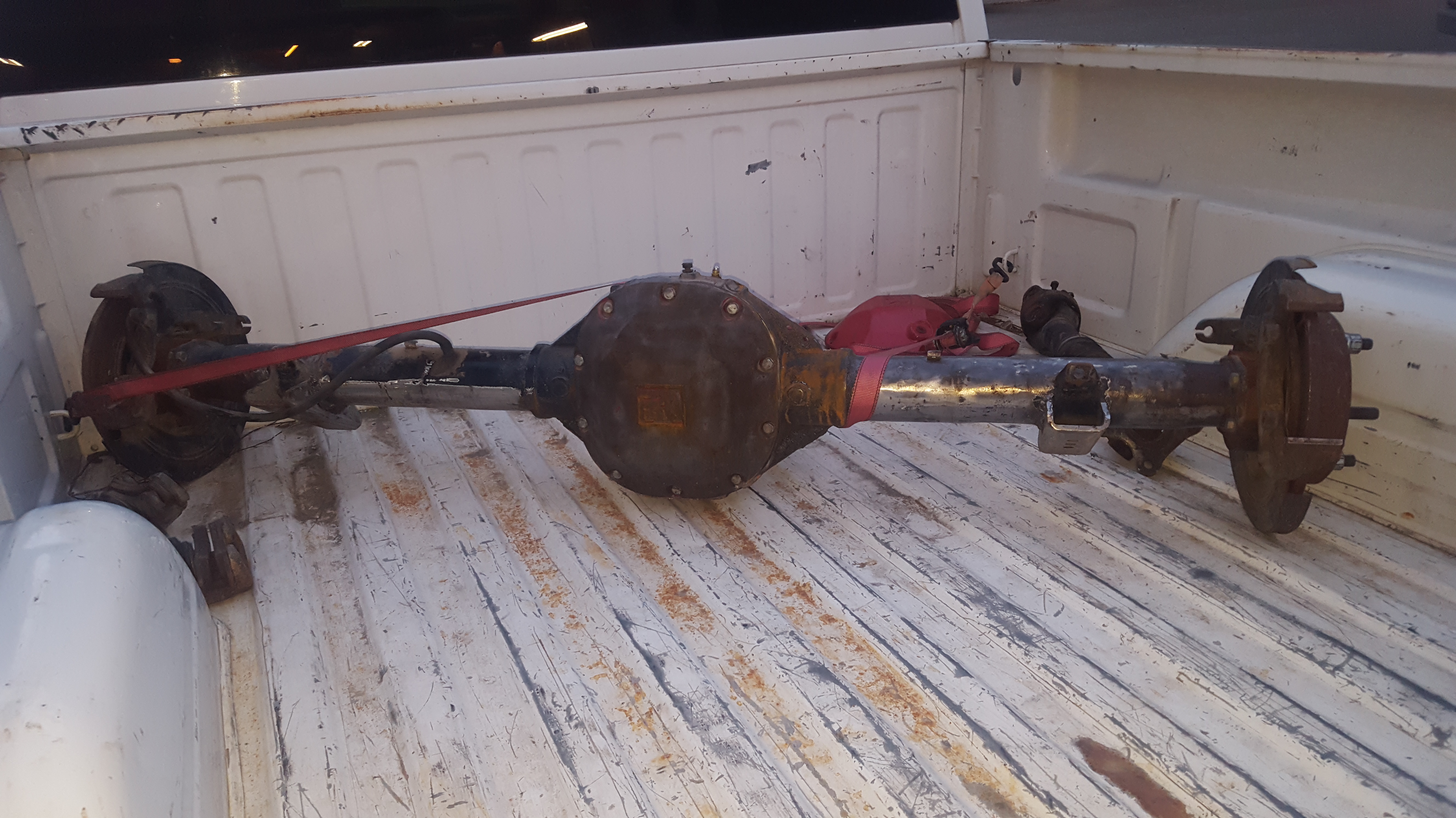

Picked up a new to me rear axle. Disk brake explorer 8.8. Has 4.88 gears, an ARB, and a cclip eliminator kit. Will be replacing my drum brake explorer axle with welded spider gears.

Sweet! That will be a nice upgrade. Help the road worthy factor too. With your soft suspension I am sure you feel that welded rear end on the street.
