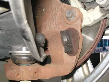

I'm getting the same rub when I turn full lock on mine too. My end links are fairly new so I know theyre not bad. But I noticed the the sway bar is actually rubbing on my tie rods. The only way I was able to tell was that I painted my sway bar since it was kinda flaking off in one little spot and checked it a couple days later and noticed the pain was rubbing off on to the tie rod. The only thing I can think of to fix it is to get longer sway bar end links, for my issue. Might be different on yours, but can give you something to look at.
Make sure the steering stops are greased. Dry metal grinding at full lock sounds horrible when the tires are rolling. :eek:
Alright, thanks, I will check it out. I'm assuming it's an alignment problem otherwise. very strange it would only do it while turning or making a deep left. I would think the new stabilizer links are the same as the ones that I remove. suppose I should measure them or just do a side by side comparison. I plan to jack mine up and have the wife turn the wheels left and right to observe.

Steering Stops? never heard of but will look for them. very odd it wasn't doing it before I change the stabilizer links.
