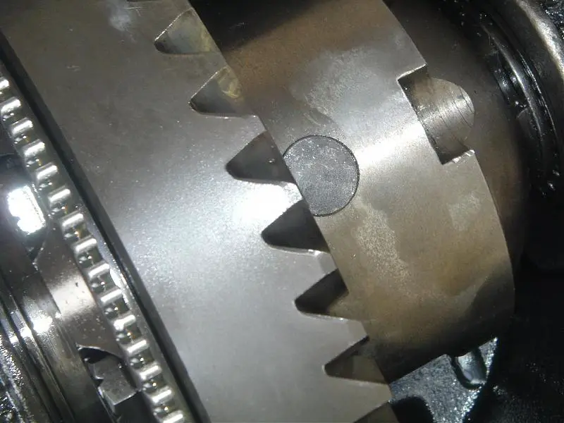

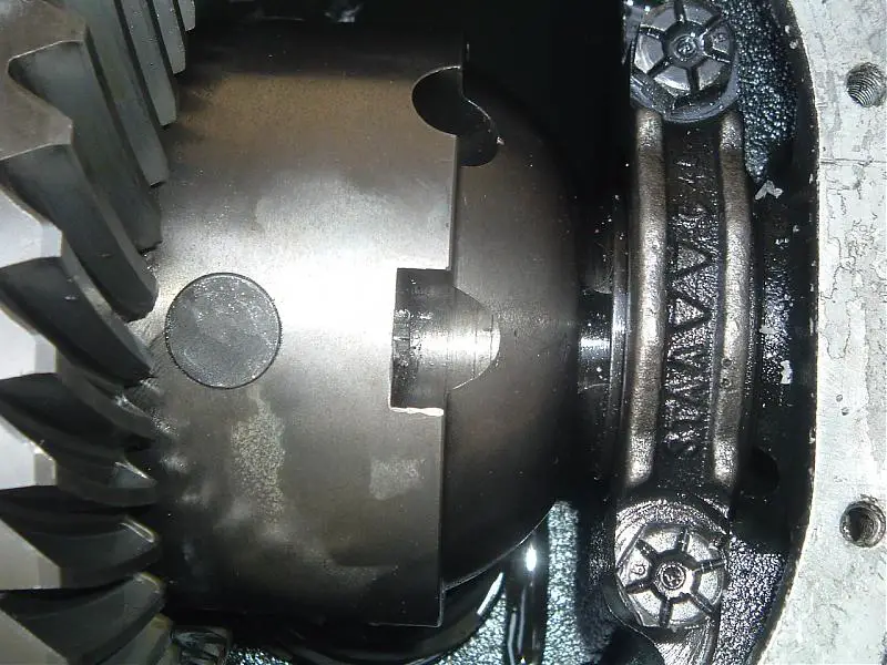

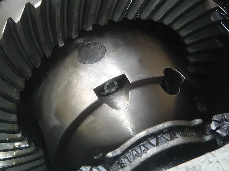

Here are some pics of what im looking at...

Interesting Sean, and there is a second bolt, on the other end of the shaft? Is that a special cross shaft, or is it a stock 8.8 part? How hard would it be to buy another shaft, and the bolts?
The other bolt isnt anywhere on the stock cross pin. Its wierd, its like it has its own pin. Hard to describe without actually seeing it. But im sure i can remove the center pin with just removing this bolt.
And its not 6 inches more like 4. I might have to get a really small drill bit and go at it this weekend. Getting another bolt will be an issue since ARB is backordered at least 4 weeks on them...
In the 2nd pic the other bolt is located in the far right opening that you can barely see...
