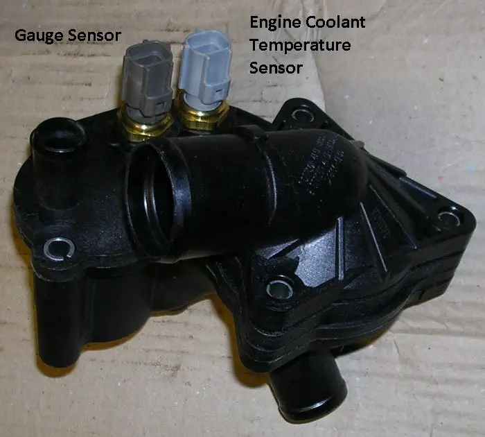

New housing with new sensors? Like this one

Thanks, 410Fortune. I replaced the thermostat housing without removing the intake manifold. The sensors in the old housing needed to come off in order to wiggle the housing out. Those sensors broke out rather than screwed out. I screwed the new ones in after the new housing was in place. I didn’t realize OBDII scanners were so cheap until I went to AutoZone to see if I could rent one. AutoZone guy said they do not rent them, but have a system to use one on your vehicle while it is right outside their door. AutoZone guy suggested I get one at Walmart for a few bucks cheaper than AutoZone low end one and quite equivalent. Did that, but haven’t been able to get the Walmart unit to work. Check engine light is on, but the OBD says no codes found. Not sure the vehicle is drivable enough to get the 2 miles to AutoZone. The sticker at the front of the engine bay near the belt routing sticker says idle cannot be adjusted as it is automatic. However, I spy a screw whereby I might MAYBE be able to adjust the air intake throttle plate resting position to raise the idle to 1500 RPM while in gear so it doesn’t shut down. Or maybe I should buy a higher grade of OBDII. I was surprised to learn those readers do their thing with the engine not running.
