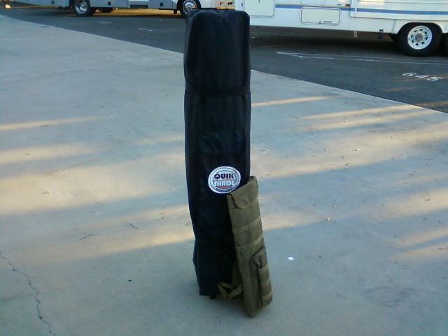

...Swapping my 10x10 "Quik Shade" this trip for a 6x10 shade...The space saver size..:D
...This was a "Doorbuster" special for $39 at 4WP's this weekend...

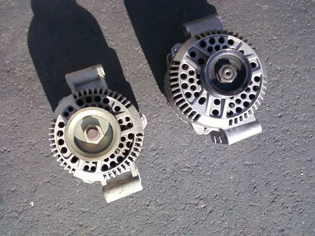

130 amp alt I haven't decided if I'm gonna run an overdrive pulley on my DD yet...I could wind up going thru alternators every year..I'm gonna try and find a used one cheap/free and get it rebuilt before this trip..Wound up just upsizing from a stock 95 amp to a rebuilt stock 130 amp Alternator..

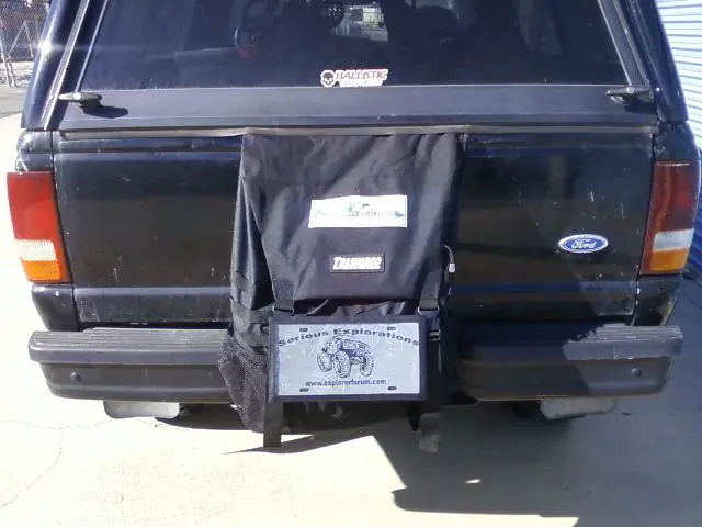

...For trash and a multi purpose duffle bag I picked up a couple Trasharoo's and also a weatherproof license plate holder from them...
