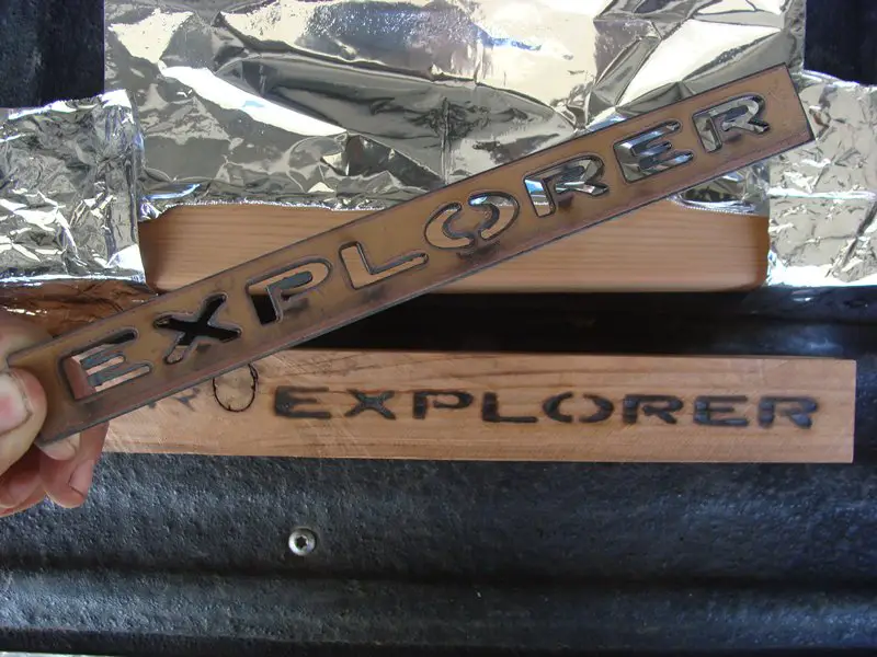

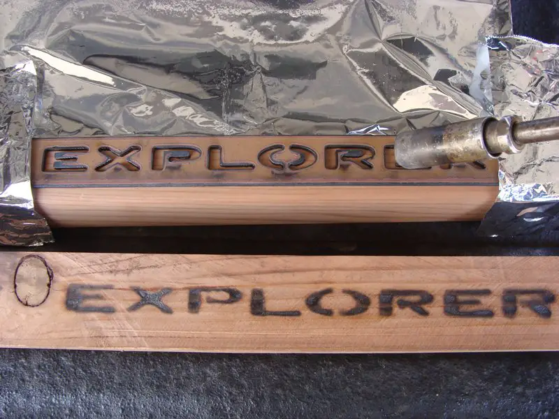

I knew I should have taken a picture of my reverse branding setup while I was doing it. When I cut my battery tray I made a sample of the text first to make sure it would cut right. So I took that test piece, the exact lettering from my battery tray (http://www.explorerforum.com/forums/attachment.php?attachmentid=66577&stc=1&d=1322684117), lined all 4 sides underneath the template with double layered aluminum tape to protect the surrounding wood and then traced the letters with a small propane torch. After it was done I just gave the wood a little scrape to get rid of the tape goo and then a very light sand. Sealed it with a clear coat and then applied camp water proofer.

..Now thats some pictures I would have liked to seen as it sounded like quite the project just lining all them letters out..
Just went out to the garage and shot 2 pictures for a pseudo reenactment. Note: for this I used Al. foil and not tape (tape is better so it doesnt move and gets a better seal) and I only lined it on 3 sides. It was alot easier than it sounded I guess. Took about a minute from layout to cleanup for the real thing. Also shown was my test piece of wood to see if it would work before I did the real thing.
Now making the template was a whole 'nother story but it was pretty easy too using my cnc plasma cutter and a computer drafting program. I re-purposed the test piece for this project and it worked perfect. It is 1/8" steel.

...Wow...Thanks a lot for posting that info as I can see that being used in lots of ways...:biggthump
..:scratch: ..That might also be another item that yourself and Rockranger can also start making for other members..No scrap will go un-used..:D

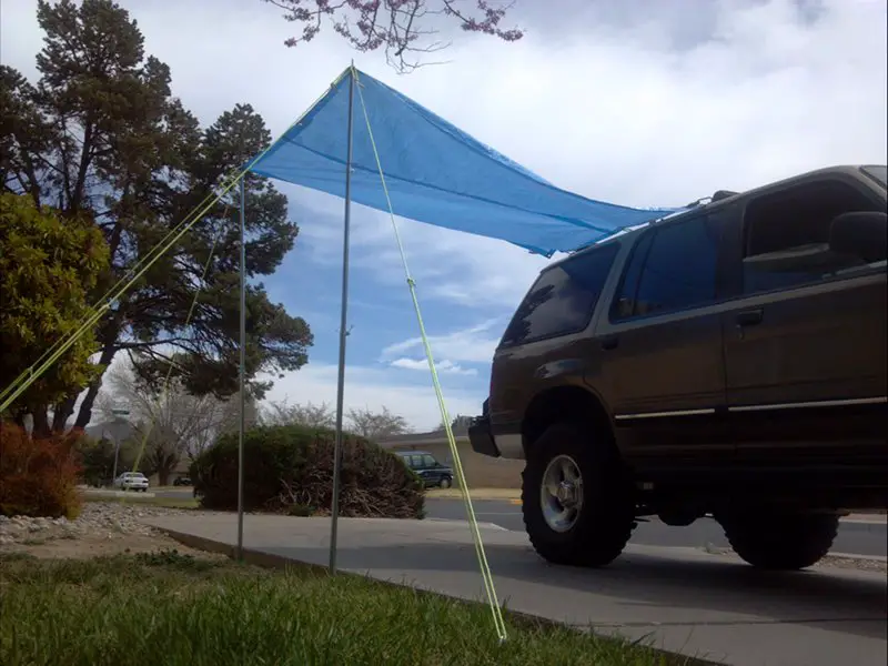

..Ok..What are you using for poles?..:scratch:
..I know that's the big trick...I've carried a 7x8 tarp for years as they can be used for several reasons including shade..
..I actually bought one of the upgraded thermal type tarps this year..Blue on one side and reflective silver on the other...It will help keep the sun from penetrating thru when using it for an awning..;)
Coleman 8-ft collapsable tent poles. They were around $10 each in Wal-Mart's camping section. They had a neat shade tarp that folded up in a small bag for around $10 (Ozark brand maybe?) as well but I already had the tarp. I also got 50' of glow in the dark 3/16" rope from Harbor Freight. I already had some rope but I couldnt resist glow in the dark!
