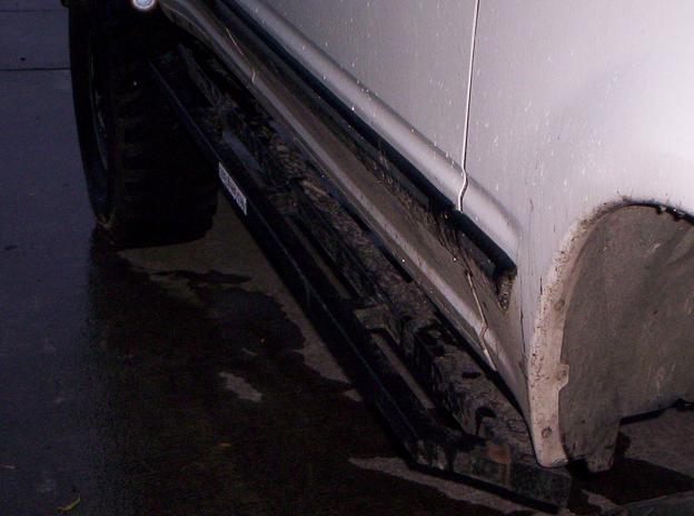

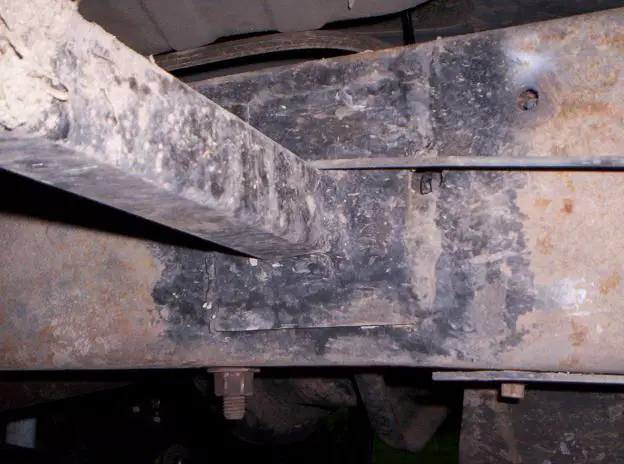

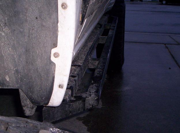

couple pics of mine
Heres a couple of pics of mine..
