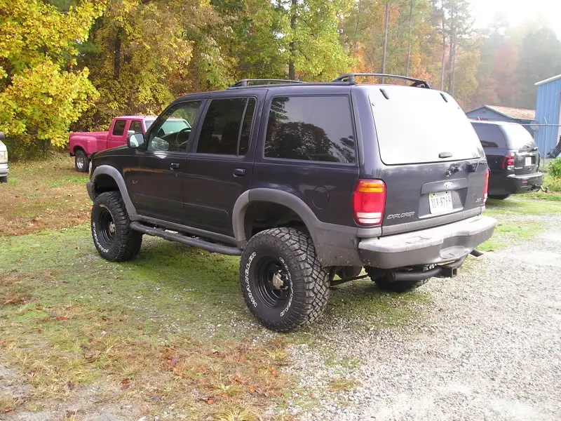

99 xls OHV
Front: 2" TT
Rear: 2" Skyjacker Dodge 1500 add-a-leaf
3" body lift
33x12.50 Goodyear Wrangler DuraTrac
The dodge add-a-leaf is perfect in my opnion. It lifted it about 2 1/2" and has settled to around 2 1/4" and rides good still, plus no longer shackle hangind down. I still have rub issues in the front when flexed up and turning due to all the plastic flares, but I'm not planing on getting rid of them, just need some more trimming.
Just about the same lift that I have on mine. Yours looks great. What wheels are you running? Width, backspace? I want mine to have the same stance.

I just removed the bolt going through the leafs, removed 1 stock leaf (3rd from the top) and replaced it with the dodge add-a-leaf. I cant say if the other one you linked will do that same because I have no idea.
The add-a-leaf was about twice the thickness and probibly 5 times stiffer than the leaf it replaced. I found a grade 8 bolt that was a little longer to go through the leaf pack to make up for the thickness.

I'm in love with the tires so far. I havent had them in major mud yet, but as far as stump jumping and ditch climbing they have been excellent. Low road noise as well!

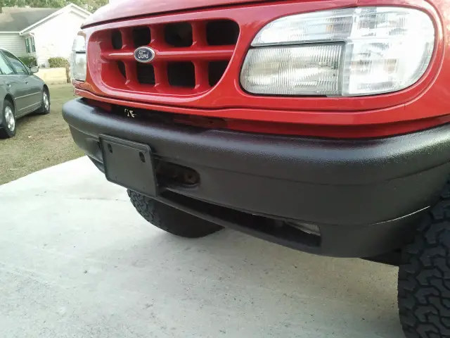

My 97 sport
Updated pictures after having bumpers and trim done by Line X
