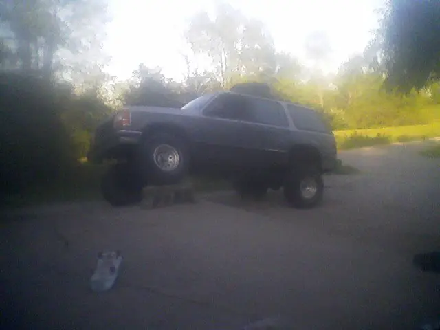

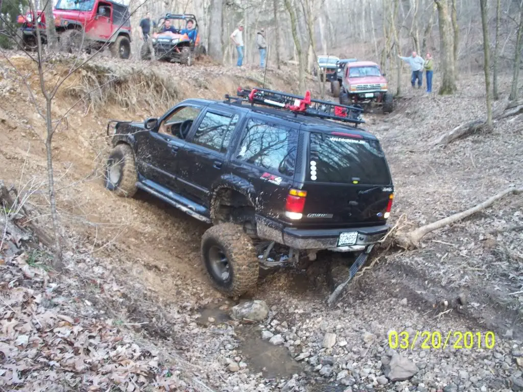

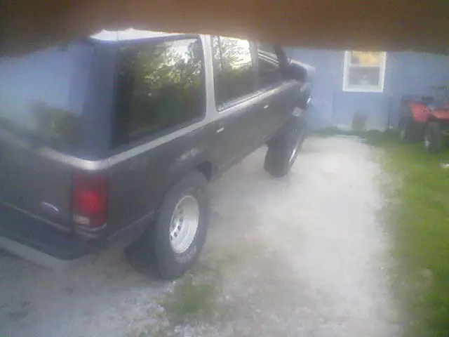

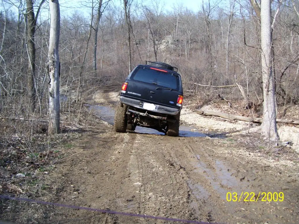

6" springs up front. Skyjacker I think. Skyjacker drop brackets and doo-dads. cant remember which shocks, bought 'em from somebody on here though. SOA out back. No sway bars, totally removed. 33x12.50x15's.
Stock front brake lines with custom mounting locations, they work perfectly.
This thing was parted up, no kits, just finding parts around until it came together. It performs very well IMHO.
Oh.. gears... 3.73's (yuk) but they work.
Motor's stock, exhaust has been modded, cone air filter and 95 explorer MAF housing. 95 Motor. Pretty good gas mileage, but it dont go on the interstate! Mileage drops quickly above 65 MPH!
Daily Driver!
