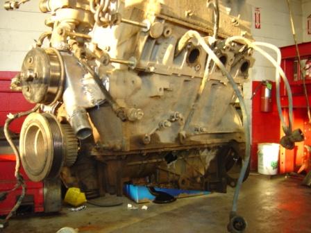

and 2000 miles after this incident my engine blows up, literally! blew a few holes through the lower pan. Putting a jasper in starting tomorrow (Sept 24).
Ill have pics of that eventually.

yup, engines done. piston rod snapped and knocked a few holes in my engine.
and im replacing it with another 4.0 SOHC.
Engine costs me :
$2800 for engine/installation kit
roughly $100 so far in other parts
I still need to buy a harmonic balancer, a new torque converter bolt, and some sleeves that sit in the heads for the fuel injectors to slide into.
I put the new engine in yesterday but there still a lot to do before running it.
Anyone who's planning on putting a Jasper in for their SOHC.. the fuel injectors dont fit into the heads- you'll need to order adapters from Ford. Hopefully those will be in tomorrow along with a new harmonic balancer and a torque converter nut. If all that's at the shop before we close tomorrow, i plan on driving my truck home tomorrow night.
Well, time to hit the sack- hopefully ill have some good news 24 hours from now.. i want my truck back :(
