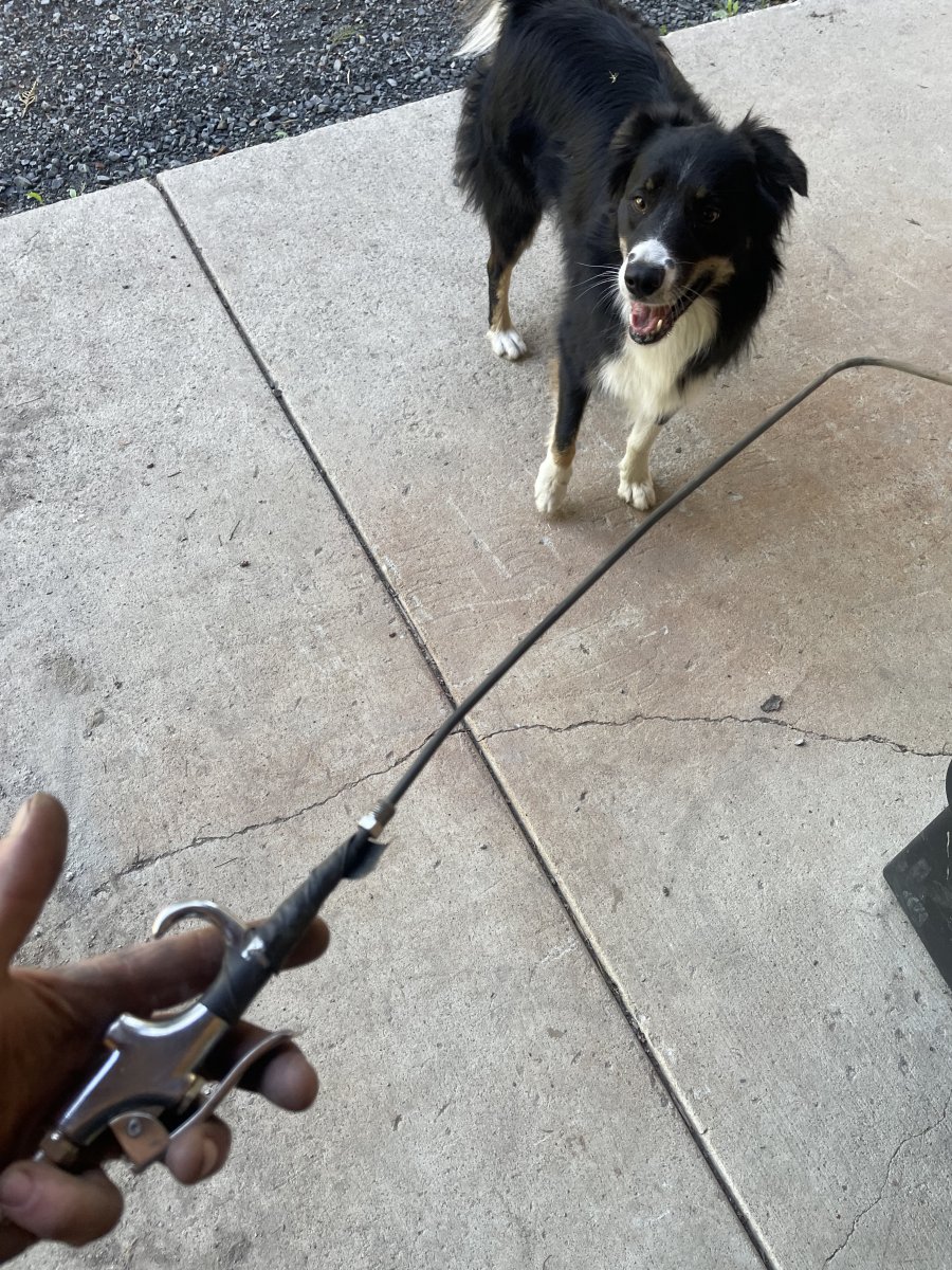

I used a piece of brake line and made an air blow gun that can easily reach in between the oil cooler and radiator and clear out debris/mud/ dust
