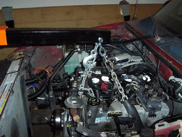

I finished cutting the exhaust bolt head off with my Dremel. I reinstalled the valve covers and hooked the chains up to the engine. I had to raise the front of the vehicle more than I wanted in order for the crane legs to fit under the front crossmember. When I rolled the crane up to the front of the vehicle I was disappointed that the boom is too short for the hook to be positioned above the engine center of gravity. The problem is the bumper prevents the crane from moving far enough aft as shown in the photo below.
I thought about trying the boom positioned at the side instead of the front but don't want to have to work around the lower A arm. I'll probably just remove the bumper. It's awkward for one person to remove but I have my "orange helper" to hold it up while I unbolt it.
Dale, extend the boom, for the engine you should be able to use the longest if needed.
FYI, be sure to also extend the legs to match the length of the boom.

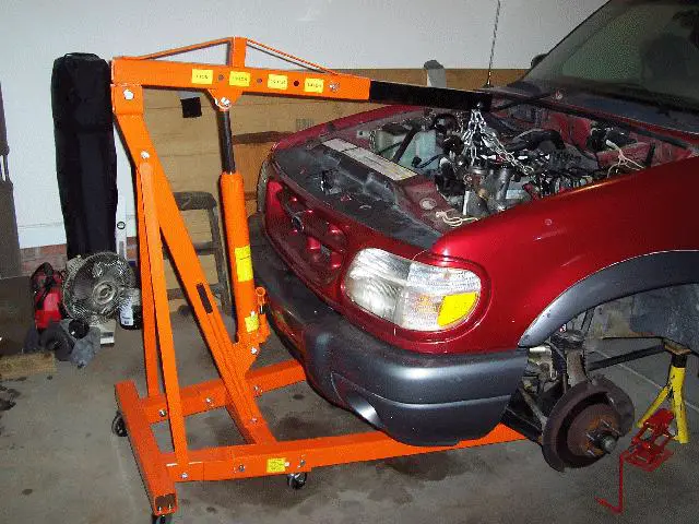

boom positions
The crane is rated for 1 ton maximum. There are four possible boom positions: 1, 3/4, 1/2, 1/4 ton. The boom in the photo is set at the minimum weight position for the maximum lift which is also the maximum reach. The leg length is not adjustable. The legs are either raised for storage or lowered for lifting.

Crane test
Removing the front bumper was easy using the crane to hold it in place while I loosened the bolts. I routed the two rear chains thru a length of pipe insulation to help prevent scratching the valve covers. I spent a lot of time adjusting the chains to get the side to side and the front to back tension equal as shown in the photo below.
Then I raised the engine about 1 inch to let it sit overnight to see how fast the engine would settle.
I plan to tie the transmission to each frame rail to keep it from moving from side to side when removing and installing the engine.

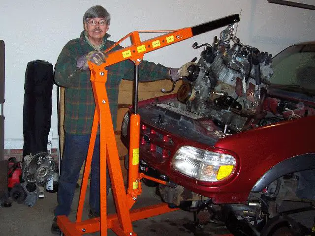

The crane passed the weight and leak test. It held up (1 inch above the motor mounts) the engine with transmission still bolted on for 24 hours without dropping a detectable amount. So I proceeded to raise it until it could clear the motor mounts easily when slided forward. I used two stacked 4x8x16 inch solid concrete blocks, a scissor jack and a block of wood to support the bellhousing just aft of the engine. I raised the jack until it supported some of the weight and then removed the remaining lower 4 bolts holding the bellhousing to the engine. As I pried the two apart with a large screw driver the rear of the engine dropped as it came off the transmission shaft. I did not do a good job of adjusting the chains to keep the rear up far enough. Anyway, nothing was damaged and the engine came up easily out of the engine compartment as I raised the boom. The photo below shows me with the engine as it was coming up out of the engine compartment.
I was able to raise the boom high enough for the oil pan to clear the radiator support. Unfortunately, I do not have the correct size star socket to unbolt the flexplate from the engine. I bought a 7 piece (E6 thru E16) star socket set but none of them fit properly. Apparently the E set is not metric so the crane will have to hold the engine up again overnight.
