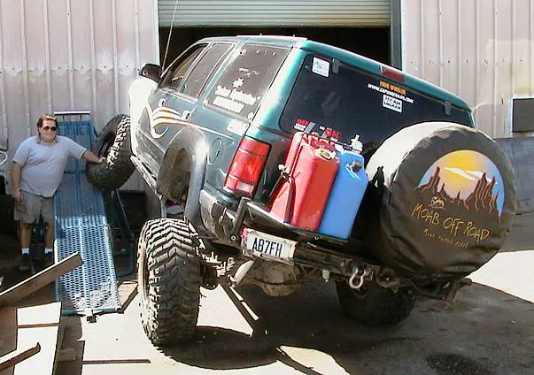

How much did they shorten the axle? I can find out exactly, but they shortened it to Early Bronco specs.
Did you keep the track width the same? Early Bronco, about 2 in wider. 60" instead of 58" I think.
How did they narrow it? Cut the end off or section and sleeve it in the middle? The housing was pulled from the diff and cut, re pressed into the diff and welded back in place. The inner R side axle was cut in the center, tapered on both ends and re-welded. Supposed to be stronger than resplining and comes with a warranty. The axle is now the same dimensions as a R side inner EB axle, so a replacement is not custom. Just buy a HD (297x ujoint) axle shaft.
How did they modify the coil buckets? They were heated and bent to fit. Afterwards, the shop said it would be easy to built new buckets...
Do the Duff coils have better flex than the superlift coils and do you know what the rate is? Duff coils are WAY better. Superlift coils are 450lbs/in and the Duff are progressive, 175lbs/in then 350 lbs/in. They ride quite nice on the road.
What needed to be done to the engine crossmember for clearance? See pics of Rick's swap.
They nip and tuck for the radius arm brackets was on the passenger side. The drivers side bolts right up, the passenger side requires a bit of cutting to make it fit.
Also, the coil perches were moved back about 1" to put the axle a little forward and make the coils line up nicely.
I just got back from running some really tough trails (see the IRC club at http://www.island4x4.com) and the truck performed awesome. Even the J**pers were impressed (when I walked up stuff they couldn't...HA).
Cheers
Dale
