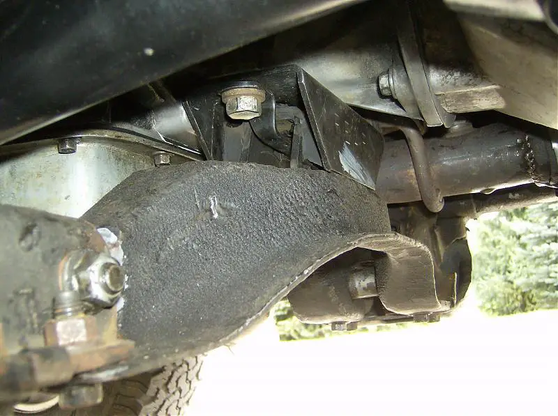

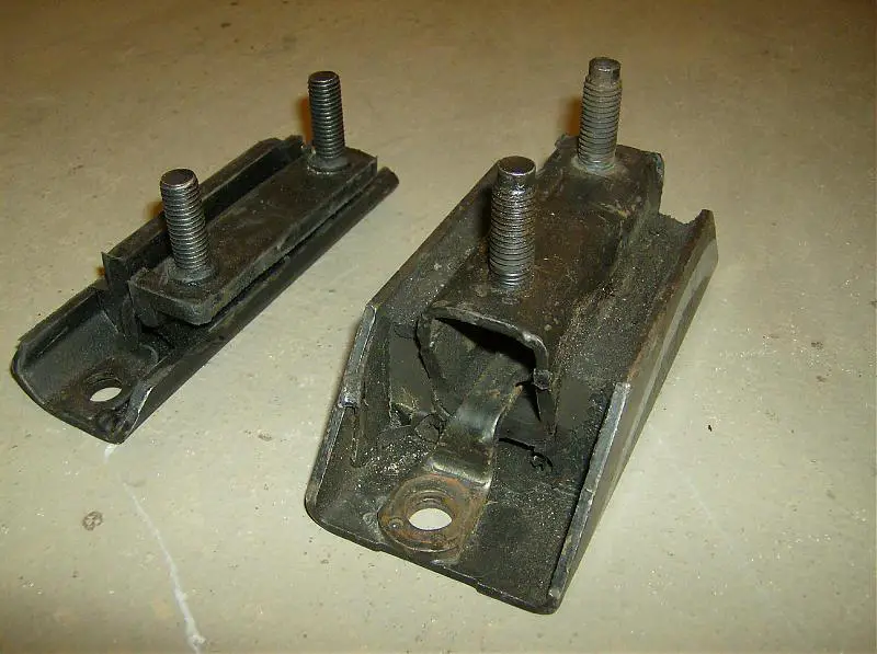

The V8/4R70W trans mount is very wimpy, even with the stock AWD transfer case. It looks like a compromise to make the big transmission fit with the V6 crossmember. Swap to the heavier BW4406 transfer case and go offroad and the situation gets that much worse.
I shortened the height of the center of the trans crossmember by just over an inch and substituted a trans mount from a 92 F150 V8 4x4. The crossmember has plenty of height left for strength and the F150 mount is designed for a V8 4x4 application. The only other mod necessary was the substitution of 2 flat head bolts in the extension housing to clear the mount.
Below is the stock 99 Ex 5.0 mount compared to the 1992 5.0 F-series 4x4.

IIRC, the F150 mount is about 1 1/16" taller than the 5.0 Explorer mount. To compensate and not disturb the driveline angles, I cut a matching amount from the center of the crossmember (it has a tall hump in the center where the mount bolts on). Then the plate cut from the top was trimmed to fit and welded back in at the new height.
At the transmission pad, the base of the wider F150 mount interferes with 2 of the hex bolt heads that attach the extension housing to the transmission. It was easy enough to remove them, countersink the holes and substitute flathead bolts.
This was done on a Ranger but should also apply to a Gen2 Explorer.

I guess your 3" body lift will keep the transmission from hitting the floor plan. Assuming that the mount is considerably taller like mine was, I would be concerned that jacking up the back of the transmission might change the driveline angles and cause vibration at highway speeds.
