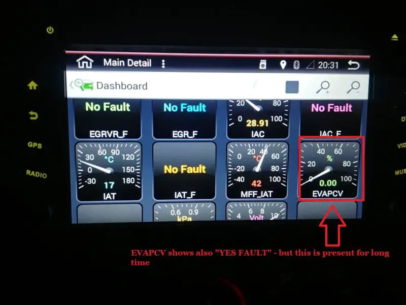

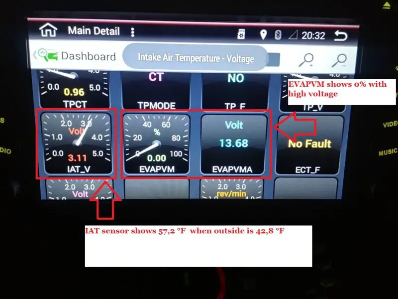

And when trying luck with forscan - I have two more potential problems:
1) EVAPCV / EVAPVM shows always 0% and evapcv show "yes fault (with no trouble code). I've read that it can cause problems with idling on hot. Have you any idea how to diagnose it without blindly changing all sensor? Maybe can I clogg it on test purposes like EGR?
2) IAT sensor show higher temp than air temp. I know that it can be caused by engine's warm but I am not sure. Voltage on 600 revs/min (neutral) is 3.11 V.
