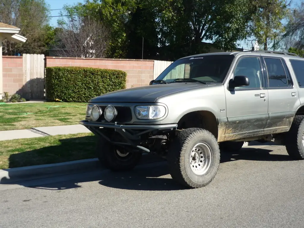

Some progress on the bumper.
Maaannn.. you desert guys and your giant "lasers".. cutting "steel".. making "gnar gnar" parts. Looking fantastic btw :)
No lasers :) Just sawzall blades, cutoff wheels, flapper discs, and hole saws for the side pieces. The tops and bottoms were cut on a shear. And thank you.

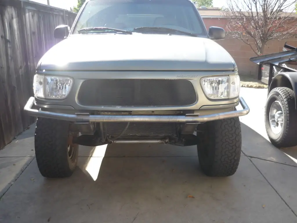

Guess i forgot to update. But since the last time i posted, i finished it, and i love it! Added the downtubes to the A-arm mount for the skidplate and a tube between those two, added tabs for the skidplate (which i still need to get cut out), added diagonal tubes to support the sides, cut and trimmed the ends of the main tube, and made a removable light bar and a place to mount a flag for Pismo and Glamis. And got it all painted and installed. I also added a crossmember to the frame because i realized there is nothing in front of the engine. It's heavy for sure, probably about 60 lbs., and i went offroading with it on and now i really need some new front shocks that i can valve to whatever i want. I'm also gonna be getting some #1 torsion bars which are the stiffest ones. But i'm really happy with how the bumper came out
