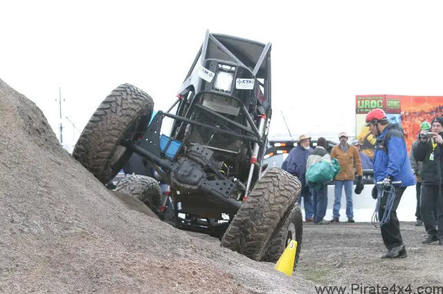

those maxxis tires are beefy and nice.. Maxxis makes good products.. only tires I run on my Downhill Bike love em.
why not get a set of bias ply iroks 39.5sx13.5 are like 360 a tire with the radials being hundred more. way cheaper
Well thats the backup plan .. if I cant find/afford either some Maxxis Creepies or BFG red Krawlers, then I'll settle for either the soon-to-be-released Interco SX2, or the Iroks.

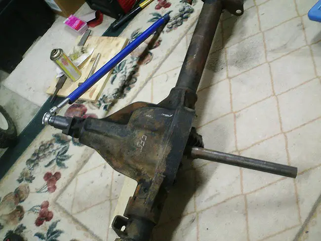

Seeing as I've sold my existence to the dark lord, leaving me nocturnal and feeding on the weak and the homeless, I thought I'd give ye 'ol pinion nut a whirl at 1am (since stupid me forgot to loosen it before removing the carrier). So in went the carrier and whadaya know.. broken D44 axle shafts are perfect for wedging into the carrier to prevent it from spinning during the pinion nut removal ordeal:

So where are working on this axle at? in the front room ?
In front of the front door haha
I have a few shafts if ya need some extras ahah lol stupid shafts
No you mortals, this is the basement where I butcher those that I feed on.
