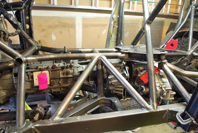

Been working on this little by little over the week.
Front upper link mount chassis end. Also made a new upper link (now that I know the final length).
Rear upper link mount chassis end. This rear upper link is the old front upper link from the first SAS shortened about 2 inches.
Also made the final panhard bars from 1.75" OD - 0.25" wall DOM. Dont have a pic of the rear but here is the front.
Taking a step back, what I plan to get done this coming week is the ribbing that goes in between the 2x4 chassis rail and the outter 2x2 side rail.

It really gets confusing trying to figure all these chassis and suspension parts out! That 2nd to last pic just has so much going on, between cross-members, panhard bar mounts, shock mounts, and what ever else I missed! This thing's really not gonna have a very low center of gravity, is it? The last pic however, looks like there's an explorer there! Good luck, and congrats on one helluva rig, Iz!
