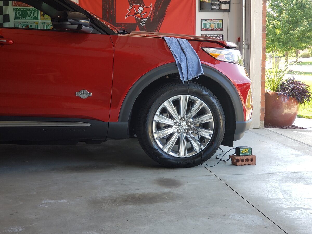

This new Explorer sure makes a lot of noises while sitting in the garage. I was messing around in the garage yesterday 6i noticed the Explorer makes noises quite often. Apparently there is something that stays awake or not shutting down. My 2019 Ram with air suspension would make noise adjusting the suspension while in the garage. No suspension to adjust on the Explorer. Anyway, I'm not driving it much early this week so I put one of my Battery Tenders on it. They sure buried the battery under plastic.... Anyway just figured I'd bring it up. I started using a Battery Tender on a Corvette a few years ago because they would kill a battery within 2 weeks of no use. The new F150 has been killing batteries quickly, too. So I'm going to start hooking them up if they are going to sit for a while.
Yeah, once you start getting a few deep sleep notifications on Ford Pass, it's time to hook up the Battery Tender when not planning to drive it for a few days.

The Explorer will go into a Deep Sleep mode after 14 days basically shutting off all functions to prevent battery drain. Although you can use a tender, it should not kill the battery by letting it sit for a few weeks. I've had no issues with it sitting.
The 2021 F150's go into deep sleep and that's the end of the battery on too many occasions to take a chance on. I own 2 Battery Tenders and it's not a problem to use them. The battery on the 2011 Shelby GT500 I just traded was the original battery (10+ years) because it was always on the Battery Tender when not in use.
I'll let you assume the "deep sleep" will work. I'm not about to find out. I've had the Battery Tender on the Explorer since last evening and it is still bringing the battery up to full charge. These aren't deep cycle trolling motor batteries. They need to stay near full charge to last. Almost a day and the Battery Tender is still not showing green.

I'll let you assume the "deep sleep" will work. I'm not about to find out. I've had the Battery Tender on the Explorer since last evening and it is still bringing the battery up to full charge. These aren't deep cycle trolling motor batteries. They need to stay near full charge to last. Almost a day and the Battery Tender is still not showing green. View attachment 340868
