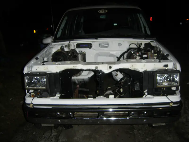

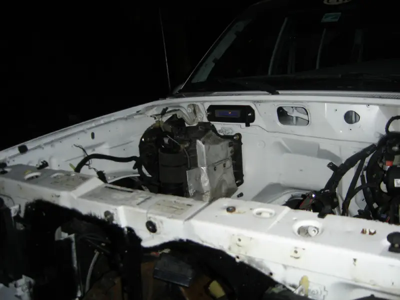

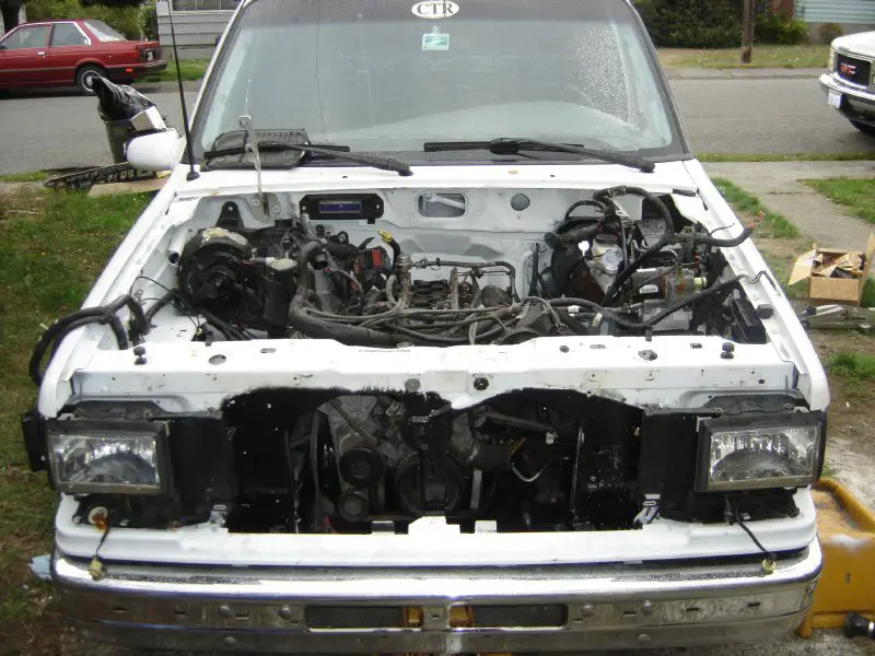

I installed the rear-end today. And I pulled it (literally) out of the garage for the first time in almost exactly a year.
`92 Front end, and headlamps..and a `97 Firewall....I think it looks AWESOME!
Ryan

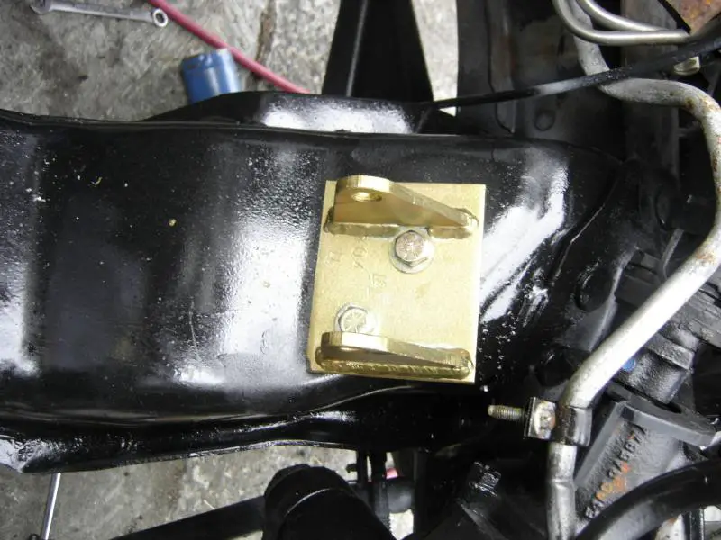

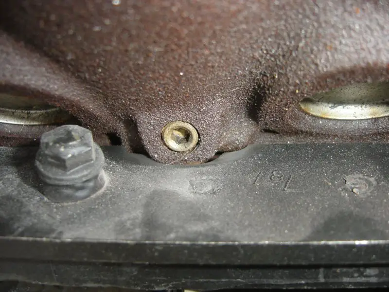

Here is the Upper Mount, on the Drivers Side that I had to modify for this 'boss' on the block

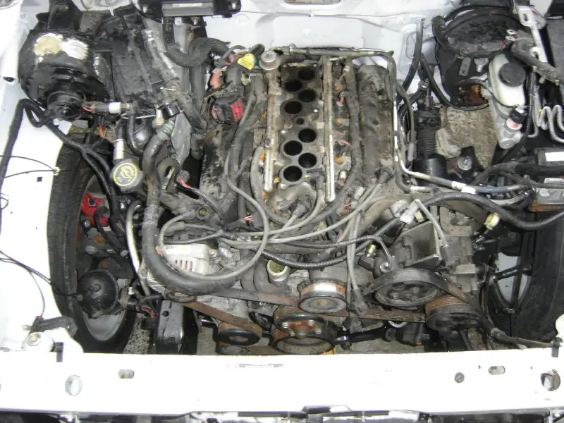

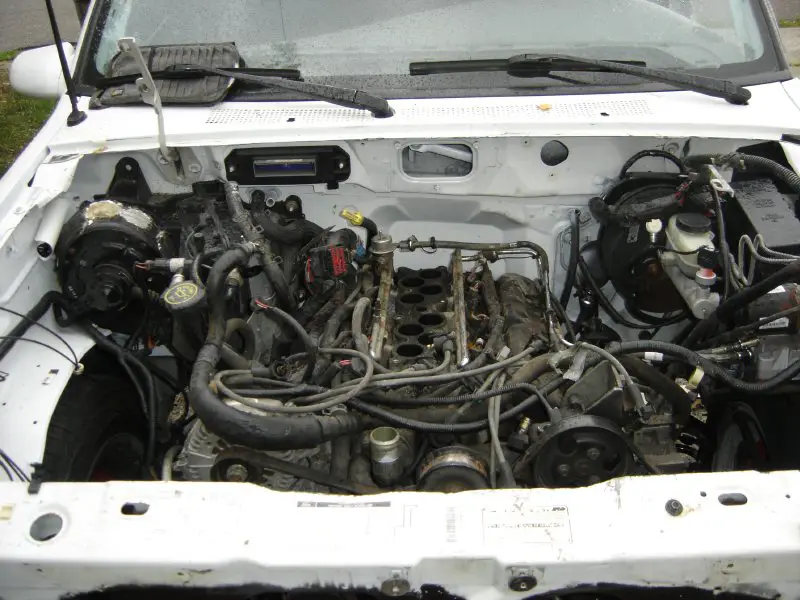

Here is the `97 Engine Installed in the `92.
Ryan
Very good, it will be fun to drive for a long time. Clean engine bay and OEM looks, I like it.
Oh, and the best part is:
The motor and transmission were bolted together. From the time we jacked the motor up off the ground, to the motor getting bolted in only took about an hour.
We started with the Rear-end jacked up in the air. Which lowers the Radiator/Core Support. Once we got the motor over the Core Support, we jacked the X back up to get a bit more clearance UNDER the car. Then we pushed the engine into place, jacked the transmission up, and undid the rear chain on the Engine Leveler that was running into the firewall. Once that chain was undone, it literally dropped right into the mounts.
Couldn't be happier with the mounts....and the install, so far. TMH's are supposed to be here soon.
Ryan

I dont know why l&l doesn't design there mounts around that plug boss on the block. I avoided with my 1 1/2" spacers but it seems a dum mistake for them to have made.
Just a thought, while you can easily. Try to seal up the seam around the freeze plugs, say at least add some RTV there. It takes along time for them to corrode there and leak, but it is a pain when they do. Try to seal the seams so air doesn't get to the block any longer there. Night,
I installed a 1" Phenolic Spacer from TrickFlow. And it caused a LOT of clearance issues with my hood. It pushed my IAC valve up, and overall it stuck up about 1.5" above the fender line.
I flipped the throttle body 180 deg. and now the IAC is on the bottom. Pics will be posted later.
The hood is installed, and all is clear.
All I am waiting on now is the TMH's.

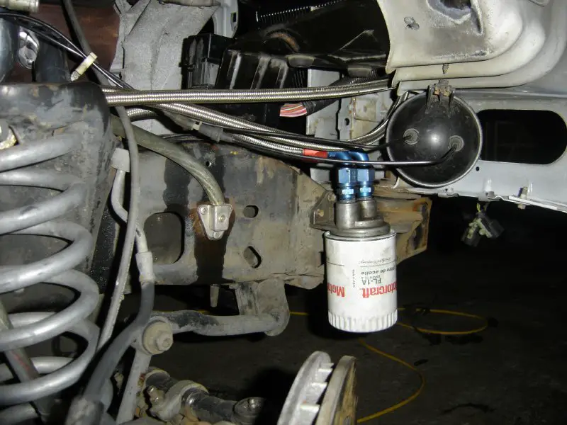

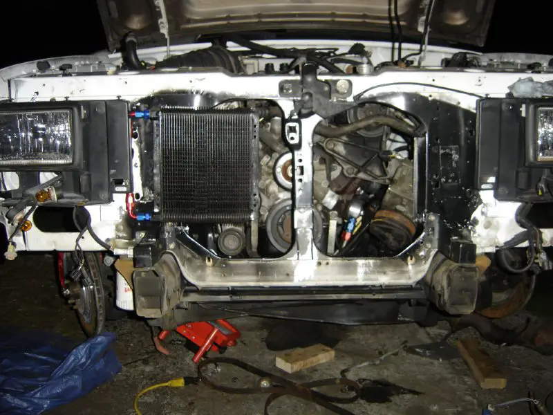

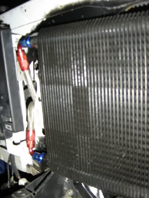

More pics...
Ryan
