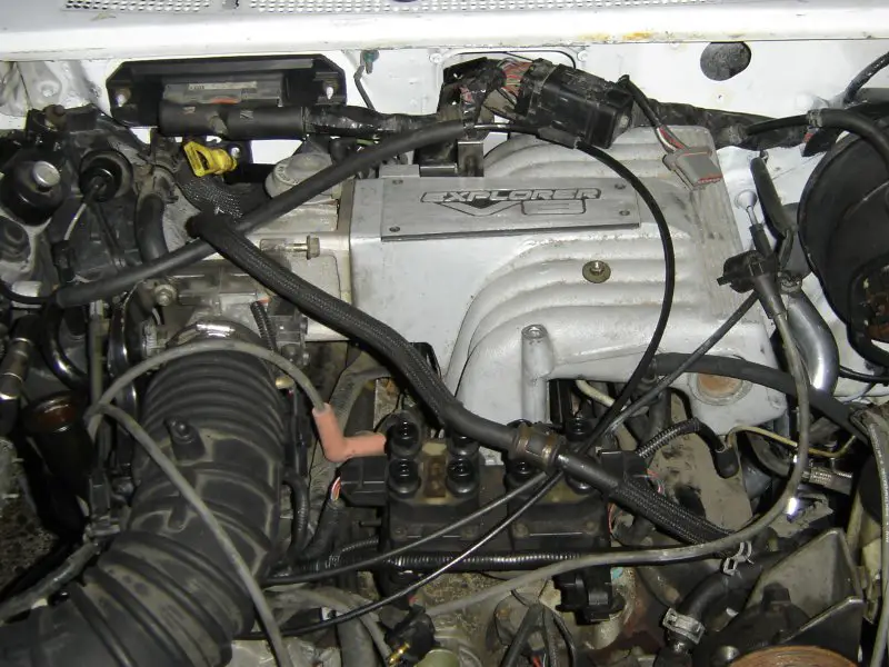

nice work so far, lets see pics of the IAC rotated, wat do you do for the throttle and cruise cables if you rotate it?

Here is the pic of the flipped Throttle Body.

That TB sideways gives you more hood clearance. Can you mount a Mustang TB and a spacer with cable bracket on it? Or did you already find a good solution?
Don...
The throttlebody IS mounted upside down in that pic....LOL
Ryan
I thought sideways, but then what throttle bracket works with it?
The OEM throttle bracket works. And it is flipped and attached, closest to the oil fill tube.
Ryan
Excellent, I really like the OEM integration. Take advantage of the best stock parts.
