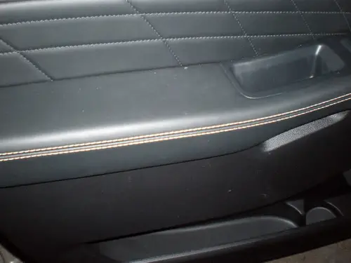

I don't think it was updated but the design changed on the 2016/17 models. Here is what the one on my Platinum looks like. Unlike my 2011 armrest, that is real stitching.
