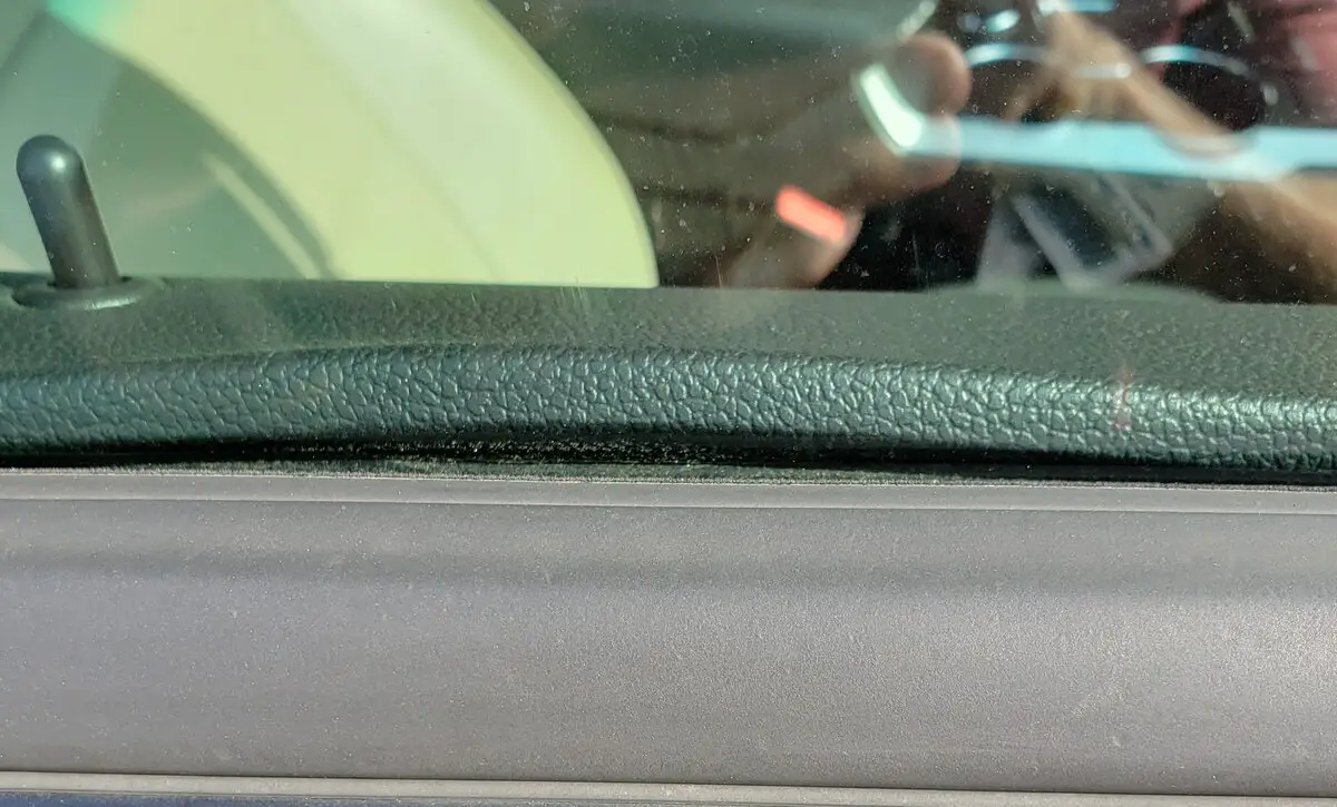

Here is the top panel that is covered under the Customer Satisfaction Program, but it seems you are outside of the 5 year window. They " Remove and staple both door trim panels".

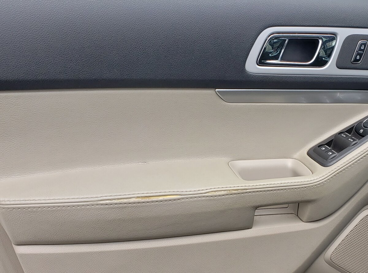

Revisiting this myself. I've had my driver side armrest professional fixed twice and my passenger armrest fixed once. Both have 1-2" splits again. I know some here have literally stitched their arrest back together and I am strongly considering that. Tired of paying to fix a poor design. The good news is, everything else on my 10 year old Explorer is darn near perfect so it's difficult for me to even think about replacing the car with a newer model.
mine has the same issue with the door panel, took it off yesterday fixed the plastic and then glued the seam closed. I took the tape off and it seems to be holding. I will wait a little while see if it is holding if not i will try to sew it closed.
Same thing here...what type of glue did you use?
I used some loctite epoxy plastic bonder on the inside and then used Shoe Goo on the outside part of the seam. It is stronger for sure just drove it and feels more secure.
Mine was repaired by the previous owner or dealership, not exactly the most stealth job but its good enough.
However this is more bothersome which we plan to try to take the panel off to fix when we have time to get around to it.
