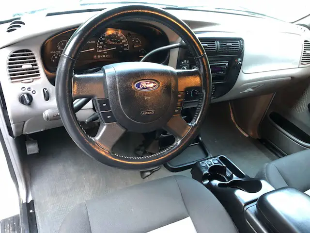

05-06 ranger steering wheel bolts on, is a really nice upgrade
shhhhhhhhhhhhhhhhhhView attachment 433203
I was looking to see if this worked!! Did you just keep the explorer airbag? Do you think (since these are similar in style to the same year escapes) that one of those steering wheels would fit as well?
