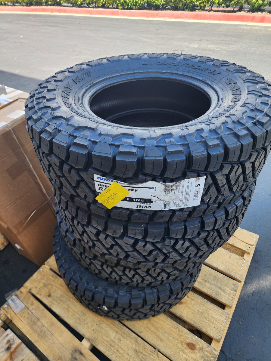

Time for new shoes again.
Toyo Open County R/T Trail
285/75R17
This is actually set #4 including the original set. But the original set was only on for less then 10k.
what made you switch from the falkens?
Could not get the Falken in the size I wanted originally. Also it's what I can get through work.. wholesale and no tax 😁
ok cant argue w/ that!!!
