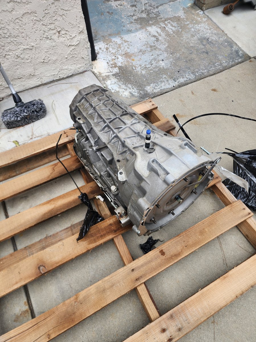

Well it's been 5 years of owning this truck, and I just ordered it's next addition.
A new transmission 😮‍💨
The 10R80's have a design flaw, the CDF drum, where a o ring rolls and blocks the oil passages. This results in shifting flared and even hard shifts from 2-3 and 7-8. The cold really makes it act up. It's been acting up since about 65k (you know just out of warranty) and slowly gotten worse over time. Now at about 90k (+6k flat towing) she has become pretty bad. Today it actually just got stuck in 7th gear at a stop light, and the would not move. It finally went back down to 1st, but she's pretty much done and any future driving is risking a trip home on a tow truck.
So now we replace. I have heard Ford will put a new updated CDF drum in, but at $6-7k, that's a not a option. In the past knowing this is coming, I would be hitting the trade in lot. But owning this since new and the truck being paid off, I'm committed to keeping her. So I went on eBay and found a Transmission out of a light wrecked truck for $1k with only 5k miles on it. This buys me another 5 years I figure, and I can rebuild the original with updated parts then.
Unfortunately you'll have to program that new transmission. The fact I have this same exact transmission in my ST it scares me. On the 2024 models the issue has been fixed but still. I'll pay it off a month early and trade it in before the 5 year is up.
ouch
and what, may i ask is this going to cost?
I'm pretty sure reprograming is not needed. Some of the Mustang guys have done the same swap on the 10R80'S with no issues. I will have to have the trans relearn, but I can reset that in the power programmer or forscan.
