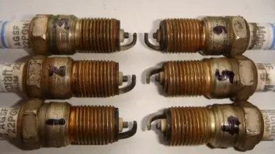

Thanks to this thread, I had no problems doing my first ever plug and wire change. My Explorer is at 183k miles and I'm pretty sure they were the original plugs. The drivers side plugs had gapped out to .090 and the passenger side were around .065. I knew they would open up after time, but any thoughts on the large discrepancy between the sides?
I made sure the new ones were set to .054. In addition, I changed my air and fuel filters. I'm really interested to see if my gas mileage will improve as it's steadily been going down lately.
