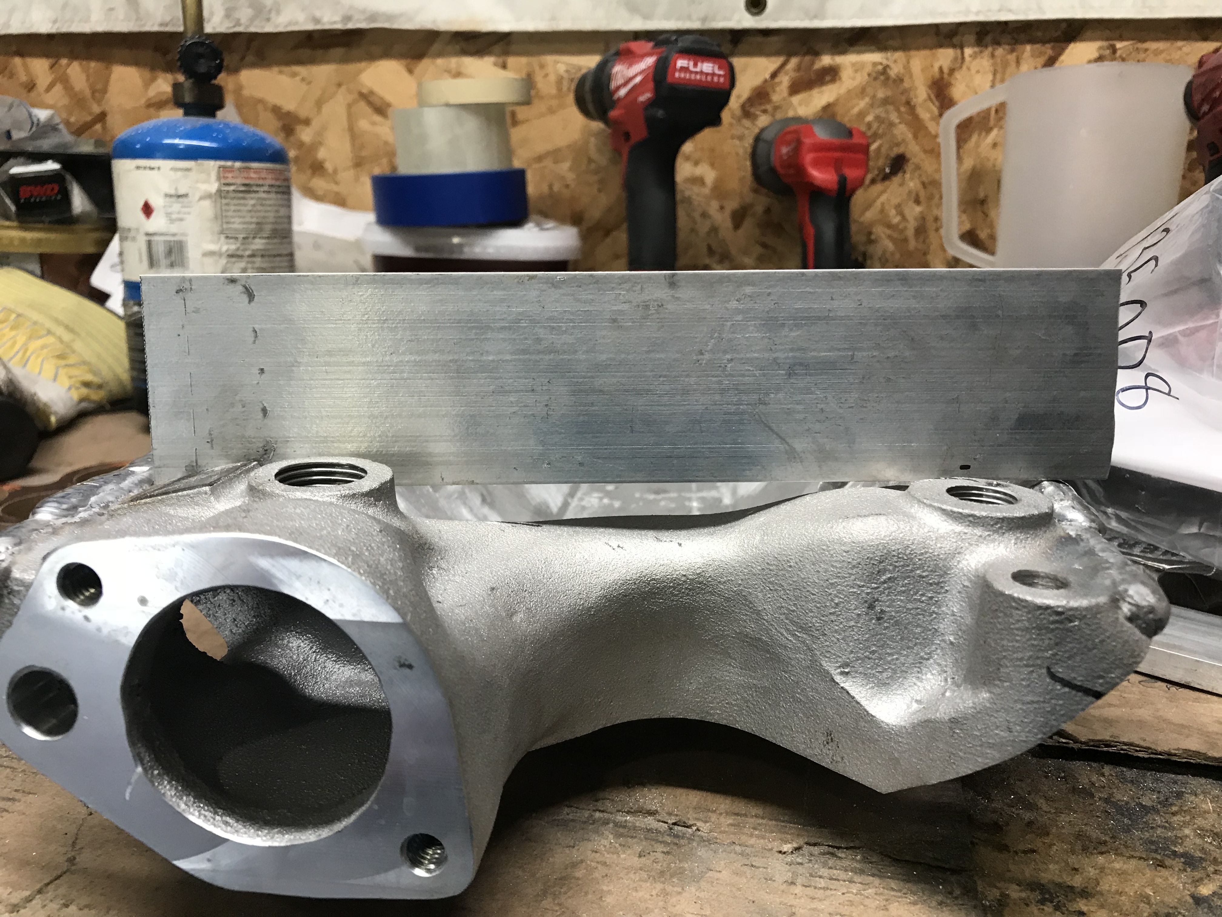

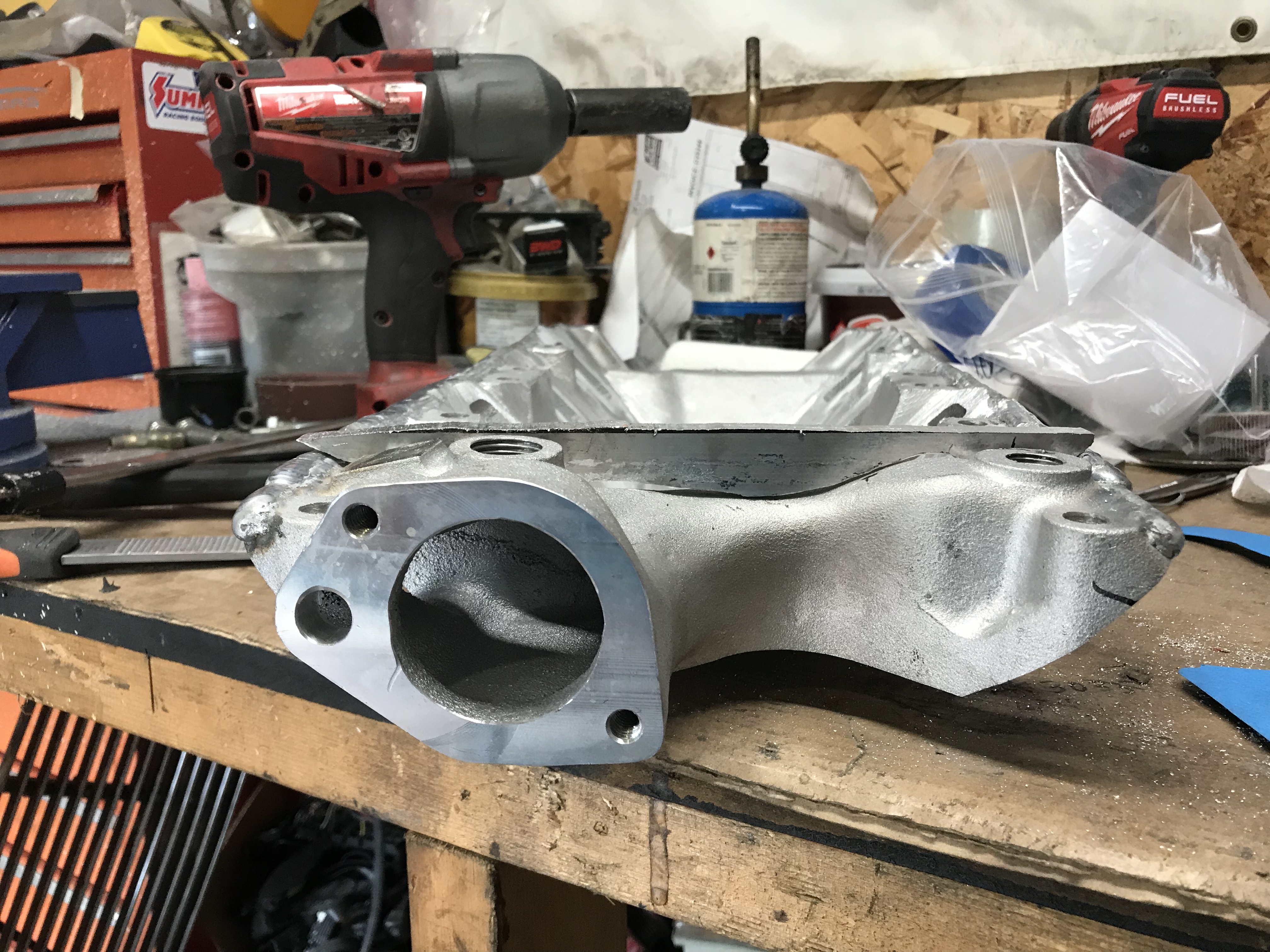

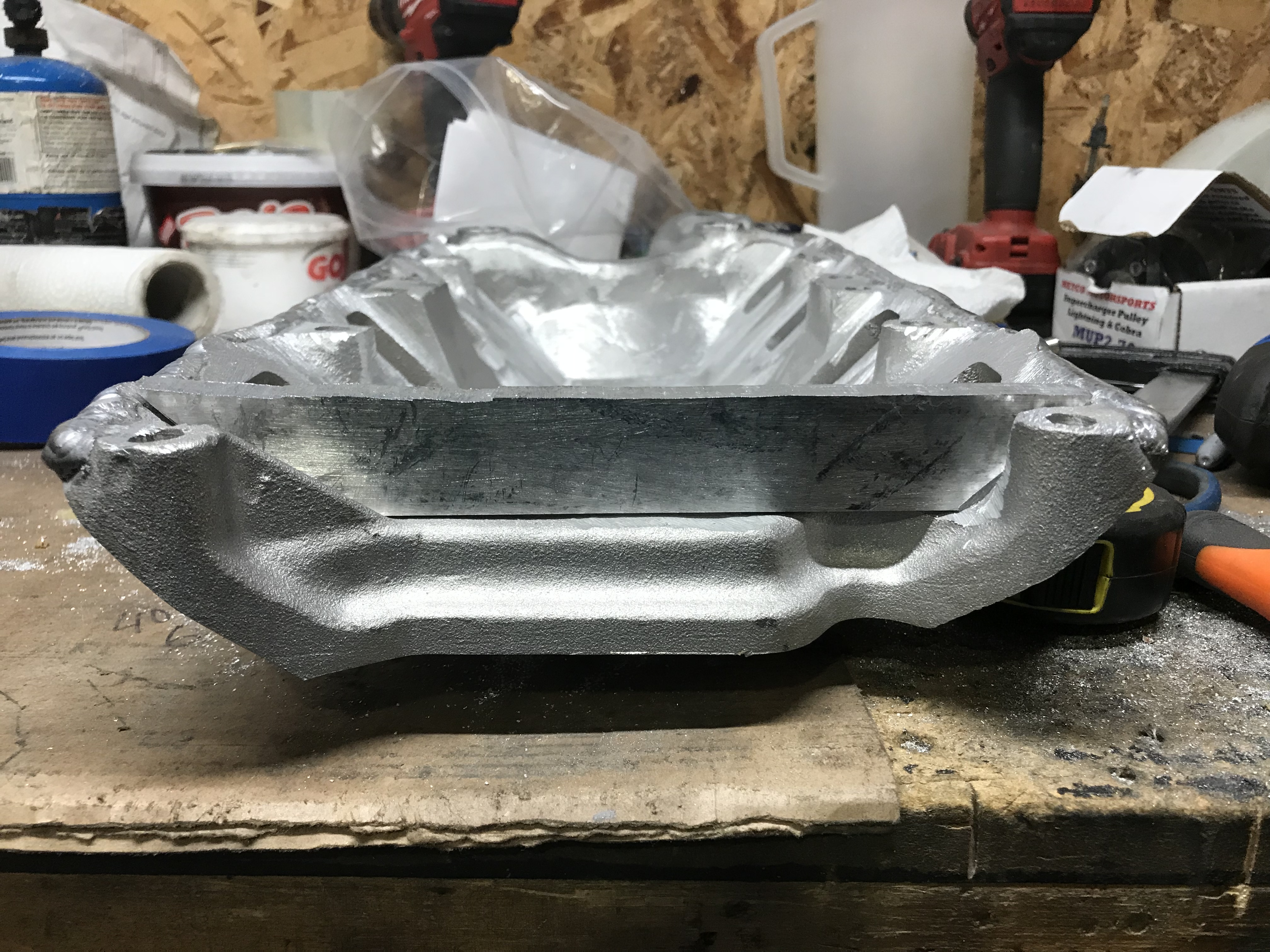

Finished the end caps tonight. Thanks to Dono for picking them up and dropping the alum plate off to my place for me. Saved me a trip into the city. Now I have to wait until Monday to drop them off to the guy that’s going to weld them in for me
So its a weld the end caps, and have the whole top milled flat? then build the top blower mount?
Lots of work just on the end pieces, looks great. the welder will be happy with the time you spend keeping the aluminum nice and tight.
exactly. made them a little higher so all of the top will mill down to the same height.....in a perfect world. then yes, once that is done i will start on the plate the blower sits on. the front has a small gap behind the water neck, but thats because there is a bend there, and i beat the hell out of it, and couldnt get it to curve, so hopefully he can fill it in.

Are you going to put any bracing through the center of that? Maybe your thought is that the top blower plate will give it the strength through the middle.
I really want this to work! it will really open up the possibilities.
i dont think its going to need a brace. the plate should be enough for it not to warp or move around.

well, i go lucky today. dropped the intake back of to the welder, and he also finished the welding that had to be done to it also today
so from there, i also went to the guy (dimas is his name) that will be doing dono's motor for him. don had ordered some edelbrock fuel rails (which are really nice, and a hellova lot less then i paid for my trickflows) and is lending them to me for mock up because his motor wont be ready for a few weeks. i also asked him what he would charge to mill the intake for me. was going to get my buddy that milled the m112 case down for me to do it, but he is away on vacation and wont be back sometime in sept, and i am not sure he will be able to do it. that and having a engine builder do it i might be better off anyway because he has a better idea what needs to be done.....he is also **** af.
when he told me the price he would need, i had said "isnt it funny (kinda but not really) that i have spent as much buying this intake as i will be getting it welded and machined?" his comment was "well, if you cant buy it, what do you do? you have to make it right? you have no other options and sometimes one off's are expensive. plus in the end, you will have something NOBODY will have" he also looked pretty impressed for what has been done so far with what i have to work with.
