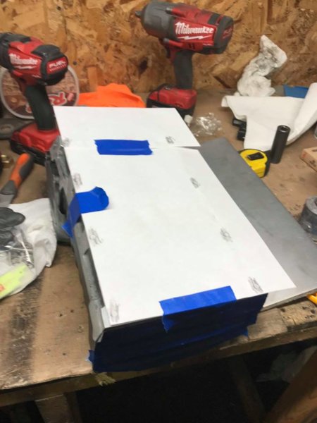

traced the holes onto some paper, then put the paper on the alum plate. centred punched the crap out of the outline of the holes, then drilled away, then that was enough. had to go back in and down some cold and flu pills.

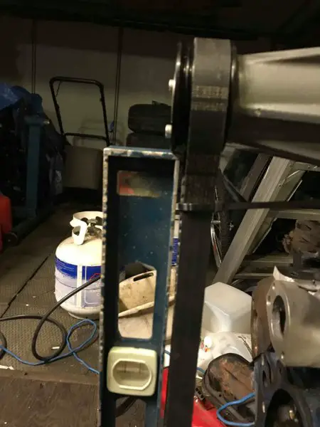

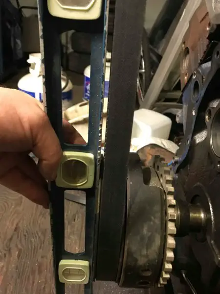

still feeling kinda crappy today. after sitting around for most of the day pouting on how crappy i felt, i finally desided to head out to the good 'ol gas chamber and lose a few brain cells. i wanted to see how forward or backward the blower will sit once everything was said and done because that is the one thing that cant change do to belt alignment. which ment the metco hub and pulley must go on. how i went about it, i am sure somewhere there is a picture with a circle and line going threw it. btw, anyone know just how far back the hub goes? is it flush to shaft, or does it stick forward a bit? the instructions it comes with leave lots for the imagination, thats for sure.
btw, this doesn't work so **** hot....

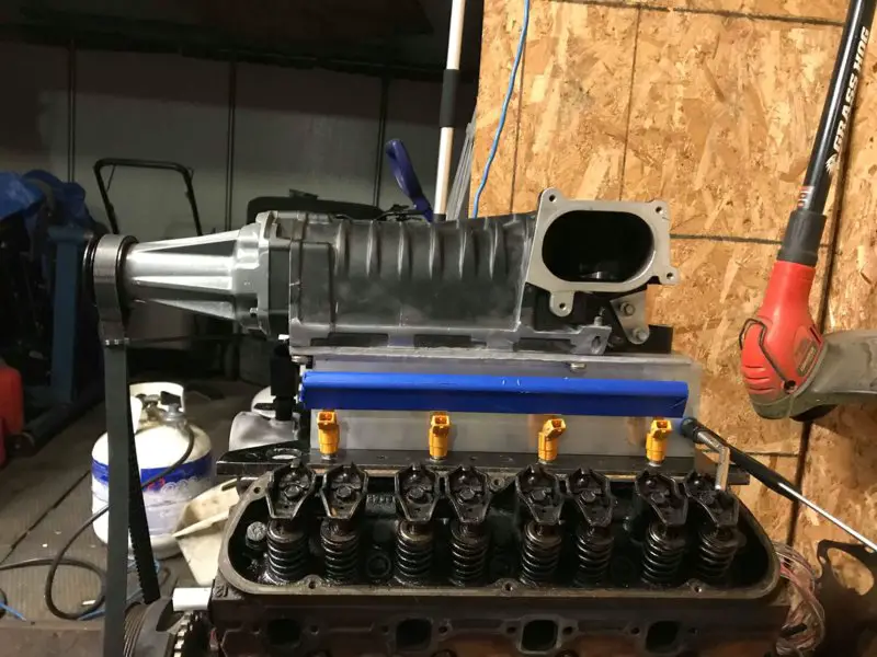

after batting with that for a hour or two, i started to measure out how wide the box will end up being. inside edge to inside edge is 4 3/4 inch. i cut one of the plates i got for the back side. i knew that one would be able to sit in place and not mess with it.
was trying to use a little jb weld to hold it in place, but that ended up being a big fail.
i ended up leaving my clamp on it, and just plunked everything on the mock up motor. its looking like the one i made for the m112 lol
so here is the part that will be a unknown. i am not sure of how much space i will have from the back of the supercharger and the firewall. also not having a garage to rip evil apart and leave it sitting over the winter also sucks, but its not something i having *****ed about already.
next up was to figure out where the belt would sit.

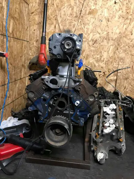

one problem did pop up that i thought i had covered, but will have to rethink is the temp sensor and heater hose outlet. i wont have the room to spin it on once the box is welded in place.
i could leave it on, but fishing the mount and blower around it when its in the truck might be tricky. as it sits right now, i may need 2 people to put this in the truck. its getting a little on the heavy side.
looks kinda goofy perched up that high, but if i want a innercooler, it is what it is. it almost doesnt seem like it overhangs on the intake like the m112 does either (you would have to see it in person to understand what im talking about).
so for right now, i will have to do a little more measuring, and cutting. there is a gap on the back side between the box and plate that bolts to the supercharger. i can cut a little off the sides at the front and slide it forward and still be ok.
Normally the Hub is flush with the end of the shaft but when customizing things we can change that within reason.
You cant push it back so far it hits, but you can have it forward some if you need to.
Just keep in mind that there would be less contact between the two parts and that is what holds it in place since it is interference fit.
So when you align and adjust everything make sure you would not have to move the pulley backwards, if that males sense?
makes sense. right now the hub is about a 1/8 of a inch off. if its suppose to sit flush, i will have to press it on a little more. that way the supercharger also comes forward a little more, making a bit more clearance on the backside. yes, once again its one of those, if i can find a little space here and there it will be better off

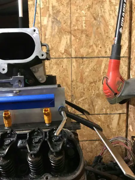

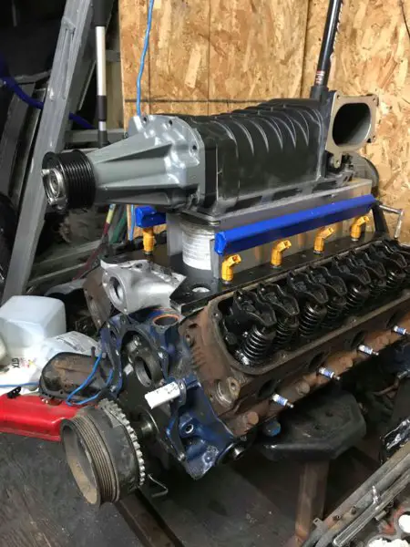

played around more with the mount tonight again
i do believe everything is now where its suppose to line up. i am going to take it to a local machine shop and have them tac weld everything into place, and refit it for one more time just to make sure it is where its suppose to be. if its off a little to the left or right, it really wont matter too much, its the front to back. if the belt is too far off that will be a problem, however, if they can weld it in the exact spot i have everything marked, it should be scary close, if not dead nuts. then once its welded i'll cut the holes in the top and bottom. want to leave them closed up for now. less warping for when its final welded vs if everything is open. once that is done, then i can measure how big of a innercooler i can stuff into it.
