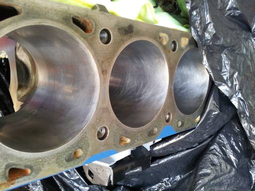

It's been a while since I've updated this thread but that was only because I hadn't had time to work on my Cobra. I've been busy build a BBF 429 to install in my buddies dad's 1973 Mach I. Here's some pictures of the build and a short video from my cell of it.
Here's the deglazed cylinders. I didn't take much off because I didn't want the piston to wall clearance to be too much.
