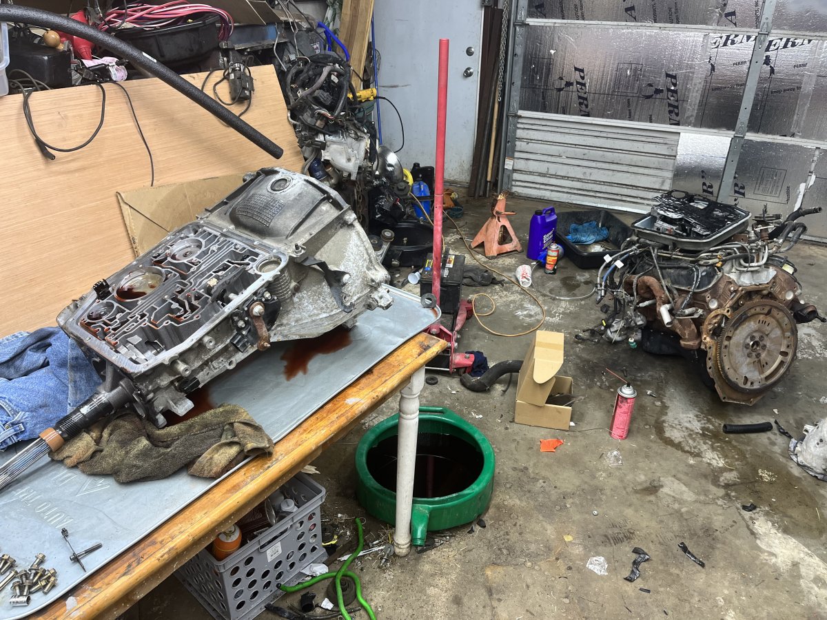

Ok. yeah, I think you're a bit confused where I'm at in the process. I've got the V8 sitting on the floor in the shop. The 2wd transmission came out with it. I left the exhaust under the donor to be pulled when I need it. I still need to build or come up with a transmission. I'm talking about pulling the SOHC from the vehicle I'm going to be driving. I don't want to chop that one (the 99) up.

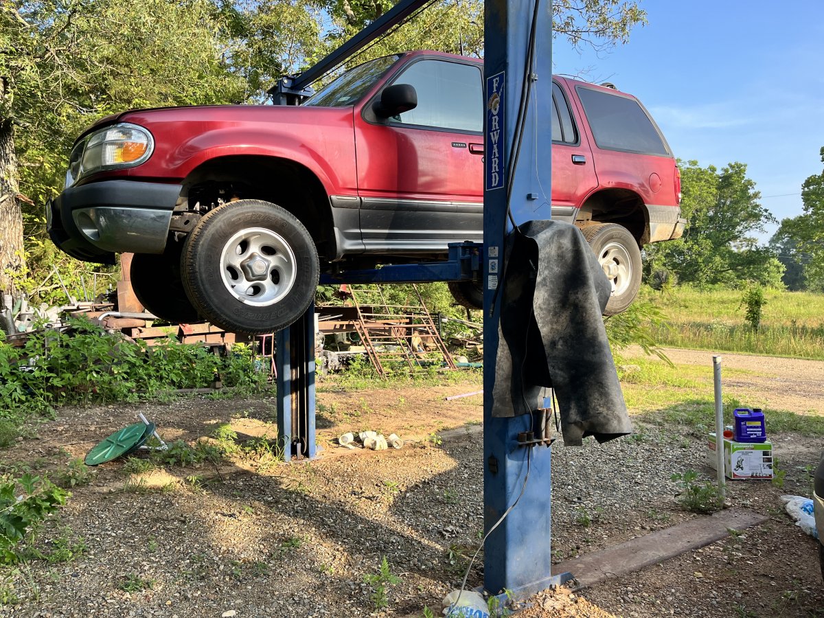

Cool! I’ve got a sport track on my lift right now
Outside lifts are cool

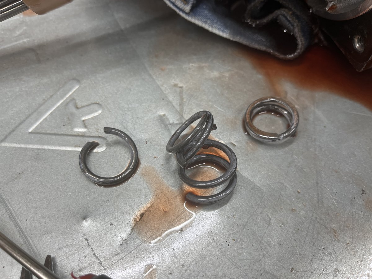

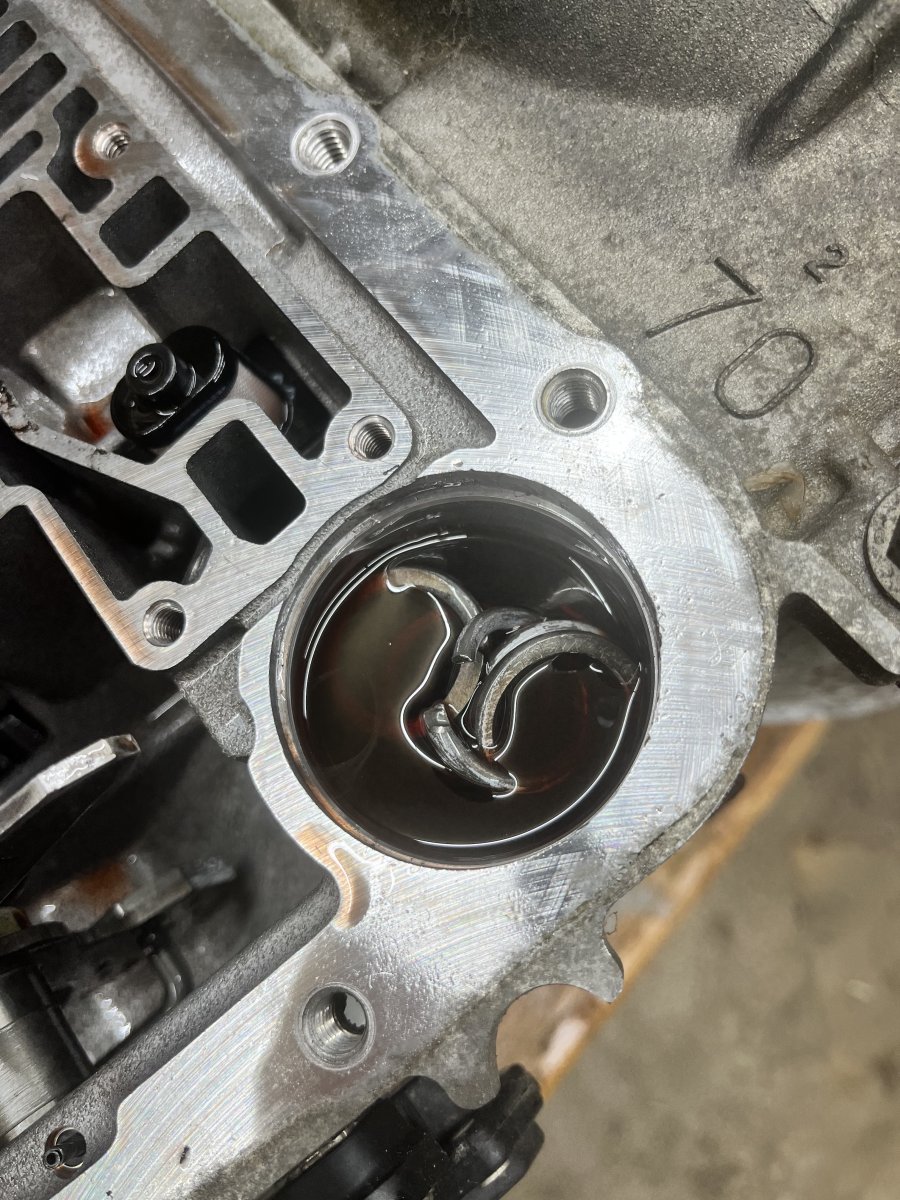

Guess I’m nearing a stand still…. Something isn’t right here.
Accumulator spring is broken very common makes for a wicked hard shift
While I wish I could be done with this project, apparently we're gonna take it slow and easy.... I've ordered the sleeve kit for this bad tranny, so maybe I'll get back on this one later. I plan on rebuilding the engine that came in pieces with the 98 EB, and eventually get that one driving too with this fixed tranny. The 98 EB needs lots of work on the roof. Seams cracking/rusting, sunroof has been taped up, so I'll have to figure out if I can fix the issues there or if I need to cut a patch from the parts MM and remove the sunroof completely--the liner on the sunroof cover(?) is torn and I'll have to look into fixing/doing away with all that. Then it needs paint on at least the roof. I'm wondering if I could afford some nice paint and do some sort of not-quick, but not fully stripped paint job because I think the 98 EB will eventually become my primary explorer and the 99 will probably go to my son in a few years when he starts driving.

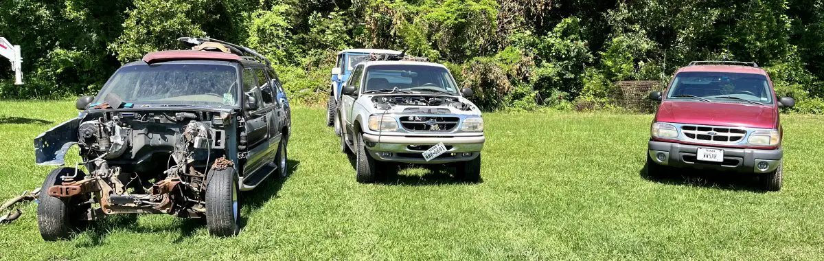

Here’s what I’m working with. Blue 98 Merc. White 98 EB. Red 99 Ex soon to be V8 4wd! And doing all the heavy moving is the 73 Bronco with 2000 5.0/4r70w/D20.
