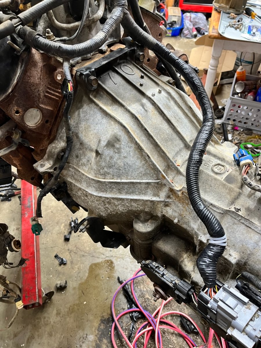

Rats!!! Sheesh
Honda makes a electrical wrap with red pepper in it to keep rodents away from wiring
Nicely done all downhill from here lol lol
Sometimes there is an air suspension wire in that connector as well… a few of those buggers are not needed
Plan to beef up the trans mount the stock v8 unit is kinda puny when hanging the 4406
better than gms soy wiring :rolleyes: thats the worste
Rats!!! Sheesh

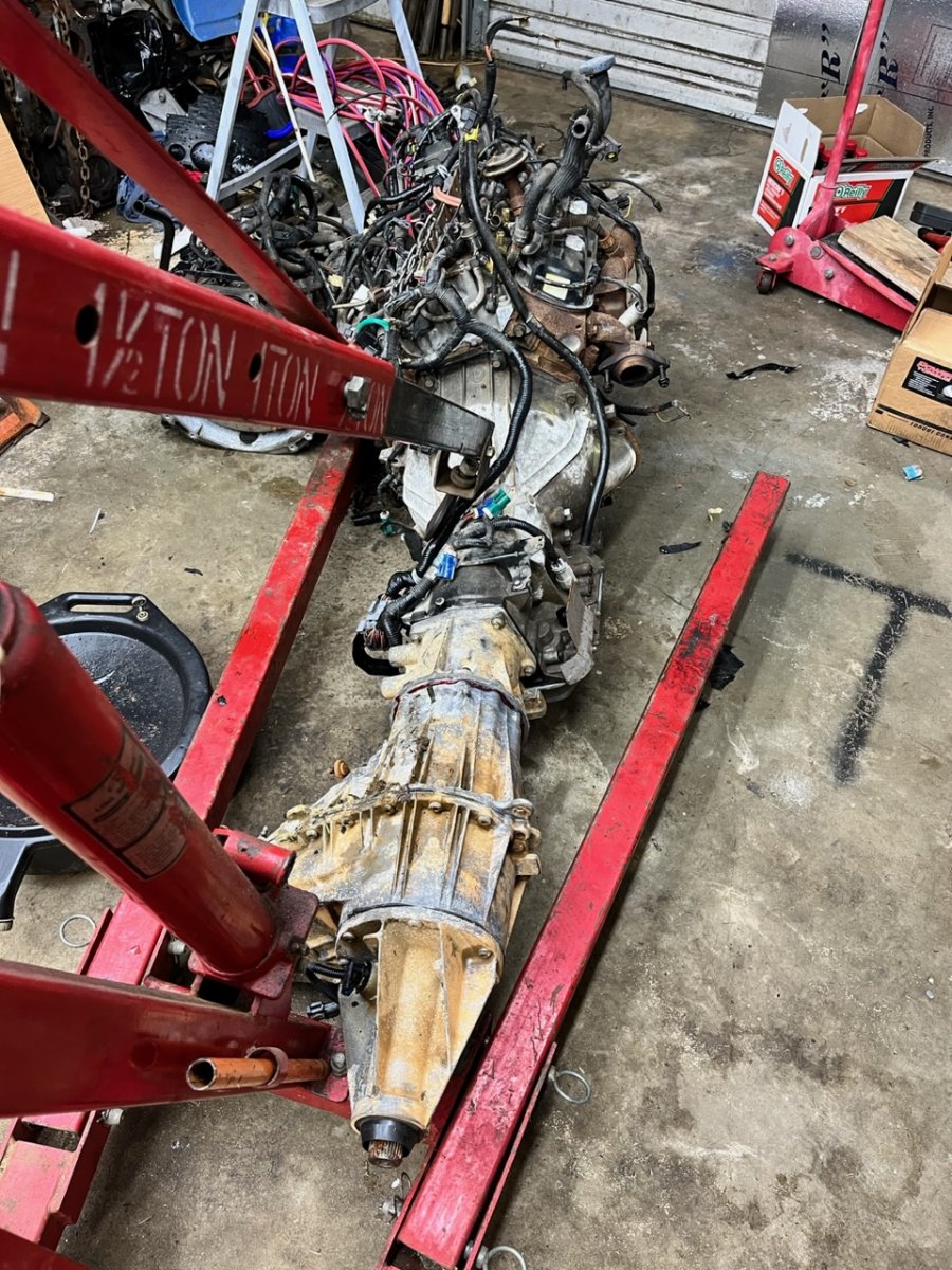

Damn I had no idea the 4406 was that big
1/2 ton to 3/4 ton t case not like our little trucks
4406 is large but not as big as the 4407 in the one tons!
well, it's certainly not as small as a dana 20... But that pic also has some perspective in it that makes it look bigger than it may be in comparison to the transmission and engine.
