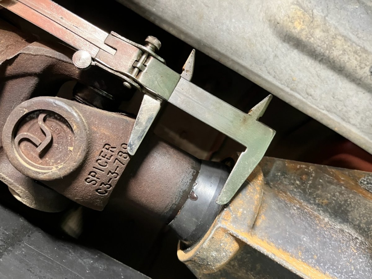

And here’s a shot of the plunge. I’ve got the cheap caliper set at 2”. I’m gonna change the u joints while I’ve got it out and I’ll look at moving the rear over that little bit. I thought from what I’d read on other threads that mine WAS moved over. I did put some pull on the rear to get it over before I tightened the motor mounts.

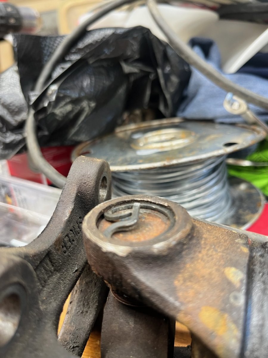

And then I find this, so I Know the u joint wasn’t put in correctly, and is probably out of balance.
That is not a lot of play from the slip yoke side to side seems about normal?
If you unbolt the shaft from the rear axle will it push into the t case more or is it bottomed out? From your pic it looks to be near bottomed out. You need about 1.5” of plunge to be available at ride height
Hmm driveshaft looks a bit tight, there should be some of the smooth shiney surface showing behind the seal that d shaft I bet is 1.5-2” too long
That I joint is installed and the snap rings in place, I mean I have seen worse! It’s not perfect but I doubt that is the issue
It's got about an inch and a half to slide in. Definitely not bottomed out. I've already ordered the bushing and seal, so I'll replace those and see if it changes. I'll probably work on moving the case over like you said, but honestly, I need an explanation of how it makes vibration go away.
