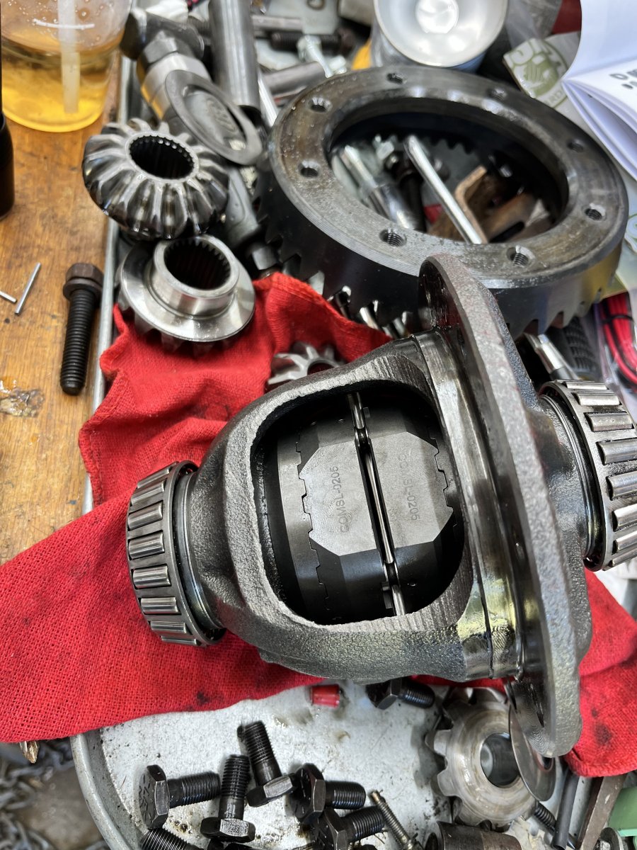

Well, I slid the spartan in there. Sat down here to brag about it and realized I didn’t machine thecsplines to accept the keepers on the shafts. 🤦🏼‍♂️. So I guess it’ll come back out. They say practice make perfect. #spartanlocker
So you have to machine the axle shaft so the c clips will fit with the locker?
NO. The splined pieces of the lunchbox don't have the depth in the splines that the spider gears do. So the C clips stick all the way out of the axle parts of the lunchbox. Theres a ring that goes inside the "drive gear" that allows the C clip to expand and lock the axle in. It works very easily.
Just be warned, i've read a lot about lockers helping to destroy CV joints. But I don't plan on beating on mine. It's just there in case I need 4WD. You know, for the mall crawling and such!

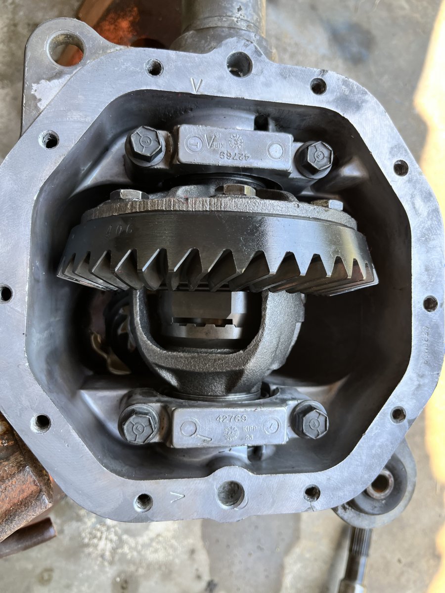

Well, the front diff is installed, axle shafts in place.
