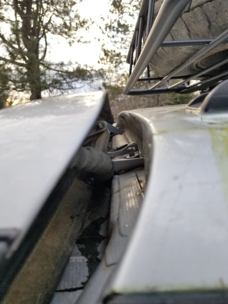

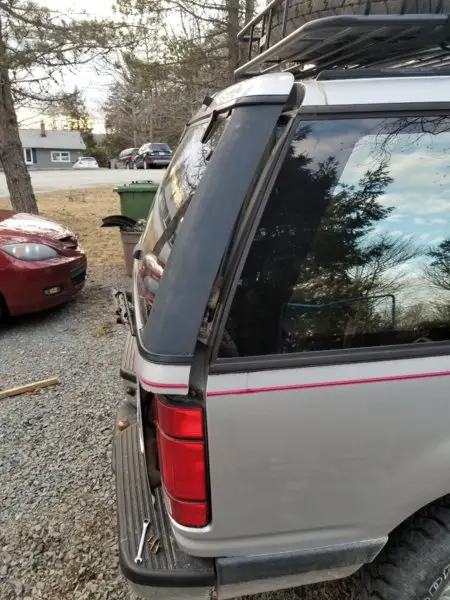

The tailgate on my Explorer wasn't closing properly when I bought it, and I've spent a good few frustrating hours trying to align it without success.
Right now I have one side half closed and the other side wont sit flush with the seal.

Check the hinge mounting surface of the lift gate, it could be bent. I have one that wont align, looks about like yours. Go look at another Explorer, 1st or 2nd gen & sight down it from the side, the mounting surface should be flat it's entire length.
If its raised or bent under the hinge you can remove the hatch, take off the glass & hammer back to flat. On mine Im just going to swap the hatch from my parts car.
Thanks. The mounting surface for the brackets looked raised (I think) so that could be the issue, but I'd have to check - there are no 1st/2nd gen Explorers anywhere near where I am.
I fought mine for awhile too. You might also check for evidence of it hitting the roof, if there are marks or a dent where it made contact there. Doesn't take much to bend the mounting pads out from where they are supposed to be.
If you remove the hatch it might be possible to push them back with a c-clamp.
oh yes, the top lip of the tailgate is all bent out of shape where it's hit the body by the (assumed) previous owner fitment

It is a catch 22. On the one hand, it is easier to do it with the shocks off. You don't have the force of the shocks pushing the liftgate somewhere you don't want it to go. ( which in that first photo is 100% the case.) On the other hand, that liftgate (as you know) is heavy AF.
I usually (not always ) align with the shocks ON. In the case of the first photo use the shock as a pivot point.
