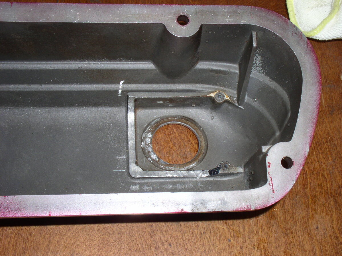

You will have to "clearance" and remove the baffle under the fill-spout.
No baffle grinding or anything at all?The Fox valve covers changed in 92 or 93 for the 93 cobra since it came with roller rockers. They don't have those rod looking things in them.
Mine fit perfect over 1.7 rollers.

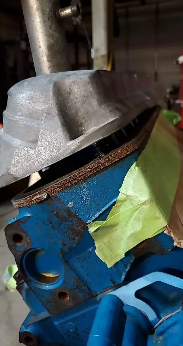

Ansen 120-4002 Small Block Ford Valve Cover Spacers
Gain more clearance for roller rocker arms with these plain finish valve cover spacers from Ansen Valve Covers. Fits S/B Ford heads.www.speedwaymotors.com
