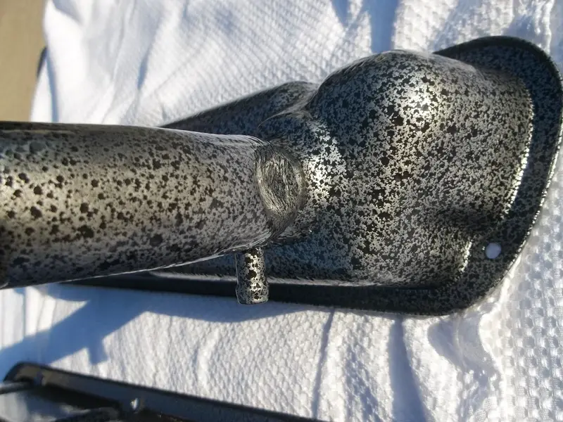

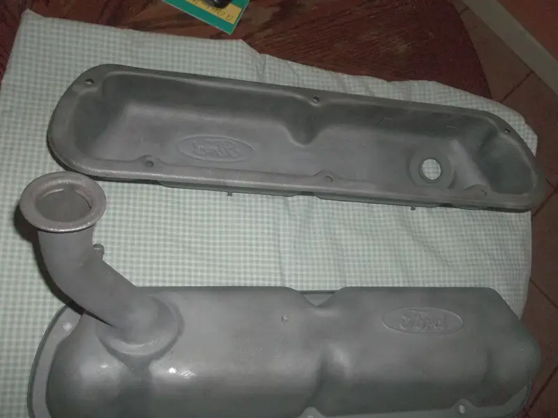

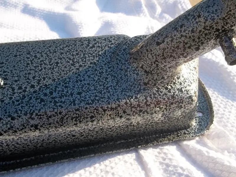

Ok, Thomas here is what I came up with.
I took the oil fill valve cover to a buddy's shop to have it welded, and then some grinding. After blasting them inside and out they looked like this
But now they look like this
Hopefully this will work for you. :D
Great work Jon, those will look good.
:thumbsup: sweeeeet. Love them, the vein look is unique and sure to look great under the hood. It's pretty crazy that I got those from a junkyard F-150.
