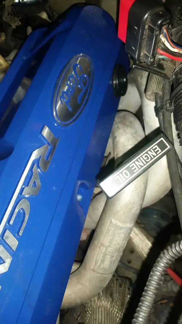

Here's a few pics I took from work. Thanks again Jon for the awesome looking valve covers. The mustang guys here love it.
Well, I think it looks great! I'm glad I could be involved from a distance, and really glad those valve covers worked out, because stock ones just look true and clean.
