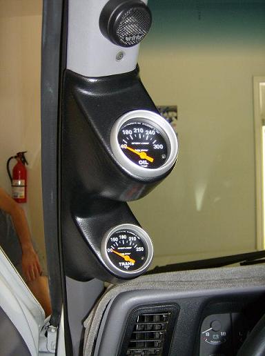

Here are some pictures of my gauge pod.
It is the original Autometer black, and mounted with Velcro.
The DupliColor gray looks like a really good match.

...That looks nice...:thumbsup:...Mine with the white faces, chrome besels, and black pod, would look way to mod...
...:scratch:...One day I may white face my stock guages but for now, I settle for my blue needles...:(
..BB, You still need to drill holes to get the electrical and such into the pod..
What's that part above the pod on the pillar? I think the velcro idea sounds better than drilling holes, and using screws.
Autometer 15308 (see post #24)
I used self-adhesive Velcro (available at most home centers, etc.)

I drilled a hole in the A pillar behind the lower gauge to route the wires to behind the dash.
One other thing I did was to use a trailer light connector in the wiring harness, to make it possible to remove the gauge assembly (and A pillar) from the truck.
Post # 24 says that the Autometer 15308 is a dual gauge pod. What is the thing above the pod?
Sorry - I misread your post.
It is an Infinity tweeter.
