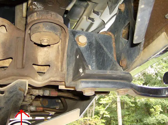

My temp sender is in the hard line between the tranny and coolers - the output side. I have a "T" in the hard line just before the hard line transitions to rubber (or, in my case, steel braided.) I should have taken a picture of this with my friend's camera.

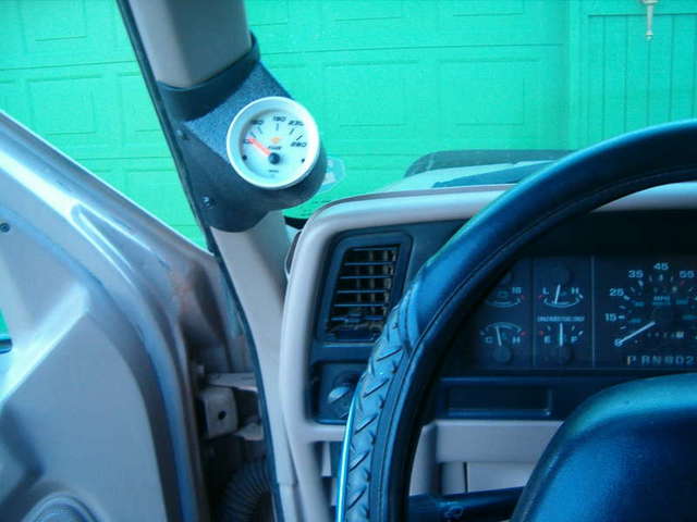

...My temp guage is all set up...I am wanting to also do a pressure guage...I seen a pressure guage on your pod so I assumed it was for the tranny..:dunno:
...Or if anyone has a pic of where I should install it would help...The one I picked up came with a plastic tubing...
This picture is taken from the passenger side of the truck, forward of the front tire. The red arrow (aren't my drawing skills phenomenal????) indicates which line the temp sender is in. The sender is about 2 inches to the rear of the arrow.
(Looks like I need to do some cleaning under there! I have new rubber body mounts - just waiting 'til the time is right to replace them.)
That is another temperature gauge - for engine oil.
