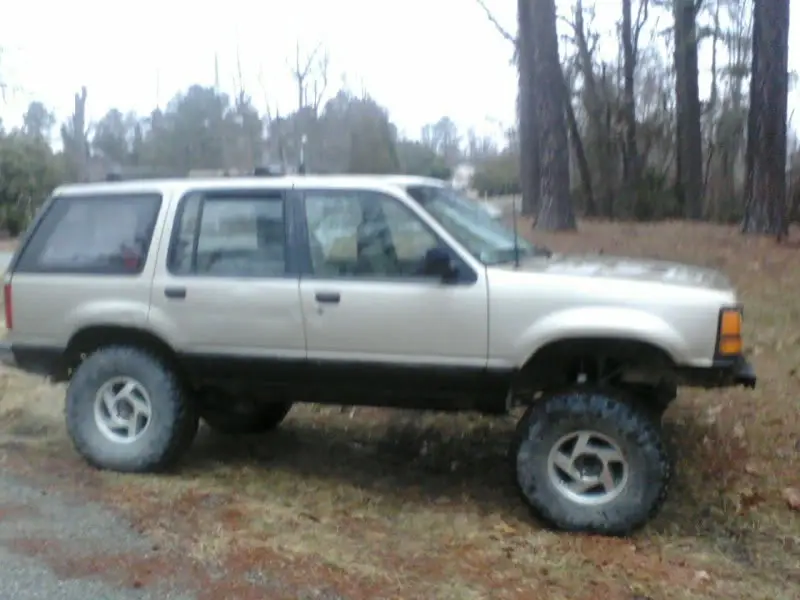

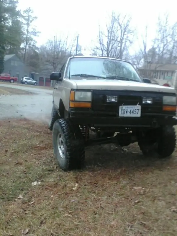

well that explorer that my starter is in is my explorer now he needed money i needed a dd so well here is my new dd
91 ford explorer
4.0l engine(stock)
m5od 5 speed trans (we swaped in after goin through 2 a4ld auto trans)
5.5 sus lift with 4" skyjacker easy ride tj coils and 2.5 spacers in the front , rear is lifted by a soa (sprinover axle) and 3" shackels
sas done with a low pinion d30 from a tj
and its sittin on mix match 35x12.50
not many other mods but more to come
