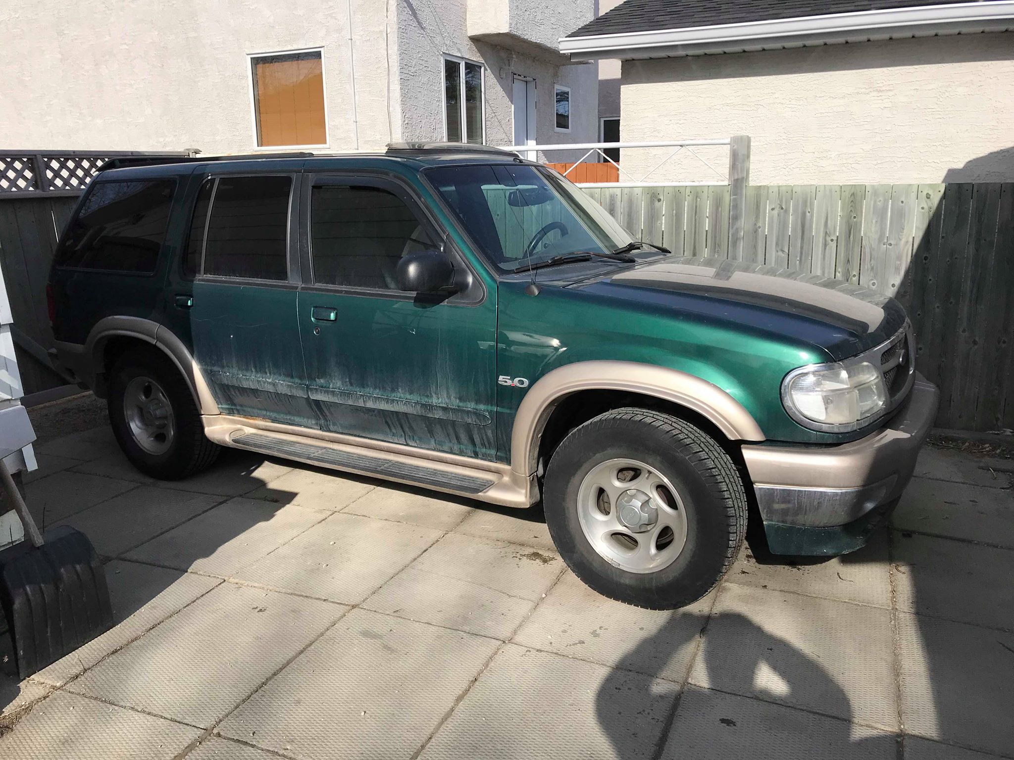

I sold my beloved ‘99 EB, but it’s going to a good home, right, @vroomzoomboom ?
I’ll never drive it again. Here it waits for the trailer to haul it to Manitoba, probably later this week.

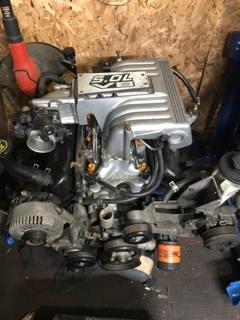

brad had contacted me the day after new years telling me that the oil gauge was doing weird things on him, and that what sounded like the top end of the motor was making noises. he had sent me a video of it, and is sounds like the lifters were not pumping up. i am thinking the oil pump is weak, or went south, or the oil pump drive shaft rounded its self somehow. either way, i know that i am facing pulling the motor. i am going to to a quick oil pressure test on it just to make sure. when i pull the motor i am going to pop a few main, and rod caps to look at the crank and bearings. if those are gone, well i have evils 302 still sitting around being used as a bench/mock up in the corner of the shed. brads eddy also has some nice parts on it that i will more then likely be pulling of and replacing with stock parts and either keeping them and using on evil, or reselling, as well as a pile of other parts brad is including with the truck (pssss, it has torque monster headers on it that wont be going back in with the motor and i wont be needing any time soon). i jumped on this truck because its a v8 and they are rare up here in canada, and its also a eddy. i have owned sports, xls, xlt, limited's but never a eddy so i can cross it off the list. the other funny thing is the stroker thats in evil came out of a 96 limited that was owned by "the other brad in canada" brad aka ford99_1979

just one of those freak things. i have seen one turn the oil pump drive shaft into a pretzel years back in a buddys mustang
Ditto, the oil pump or distributor locks up, and the shaft doesn't do well. Everyone should have an ARP shaft as spare for when you can change it.

so lets back up a day. yesterday i got a text from brad saying they are here, and loading the truck up right now.
:confused2:
wasnt expecting that to happen until next week!

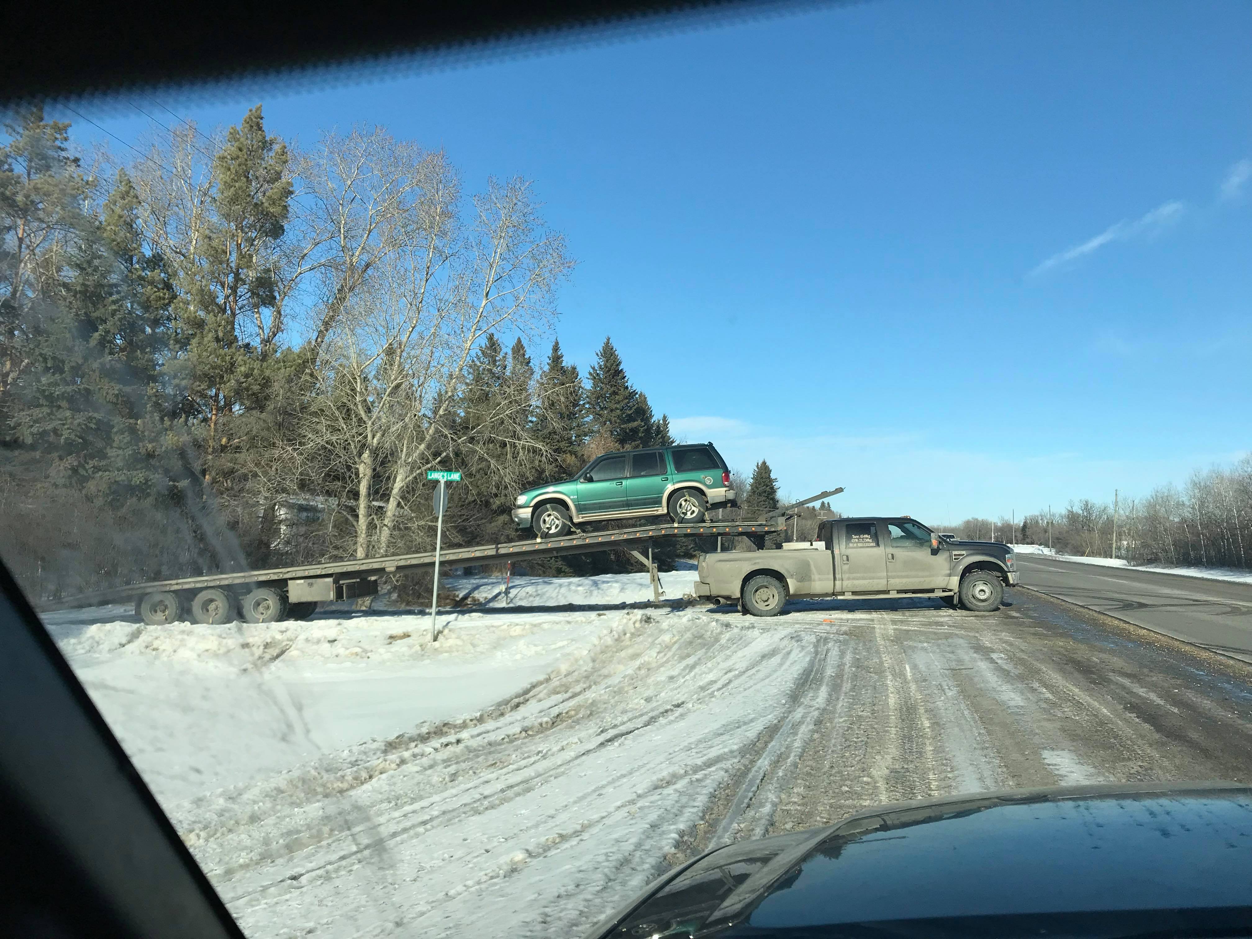

then right after that, the transporter texts me "we have loaded your truck up, and will be heading back with it today.
then it happens....
"brad said that he has loaded the truck up with some spare parts he has", which i knew.
but didnt expect.....
.....panic sets in... lol
so today at around 330pm
no word of a lie, this guy had to back down a driveway that i would say is a 1/8 mile, and he NAILED IT! ive never seen anyone that can back down a driveway that narrow and not screw up!

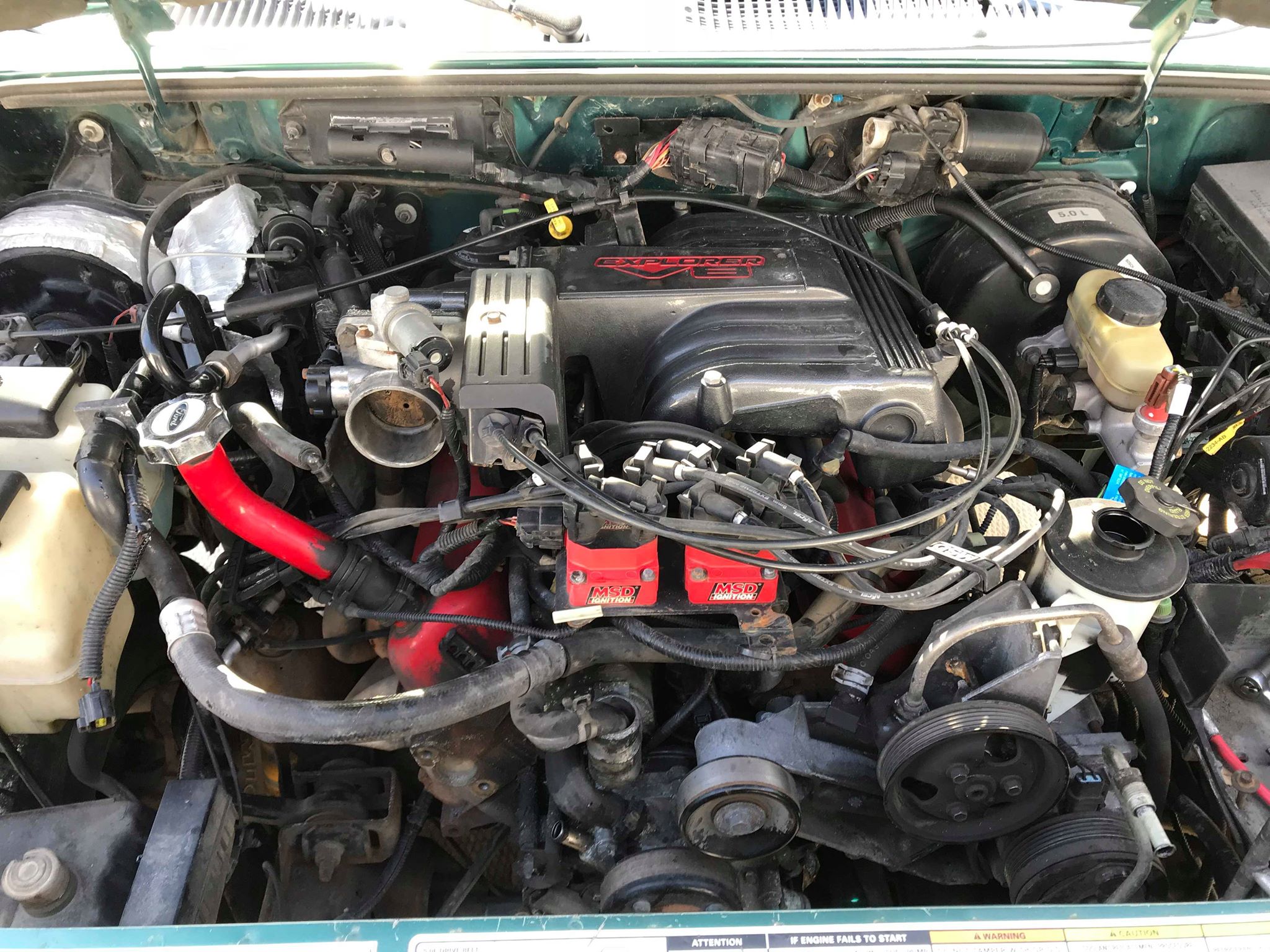

there she sits. wished i could get a pic of it by evil. have to store it at a friends place few a bit. the bad however. it was killing me to know what was wrong with it, and the noise the motor was making. the transporter couldnt cut the corner on the driveway, so i said to myself, "self, what ever damage thats done, has been done. period." twisted the key, and it fired right up. first thing you could hear was the joint gasket on the headers (and everyone that has TMH's has blown one weather you want to admit it or not). let it idle for a few seconds. nothing. put it in drive, and let it pull itself to where its parked, then it started making the noise.
she's terminally ill ladys and gents. she has rod knock. was hoping it wouldnt have that, but it is what it is.

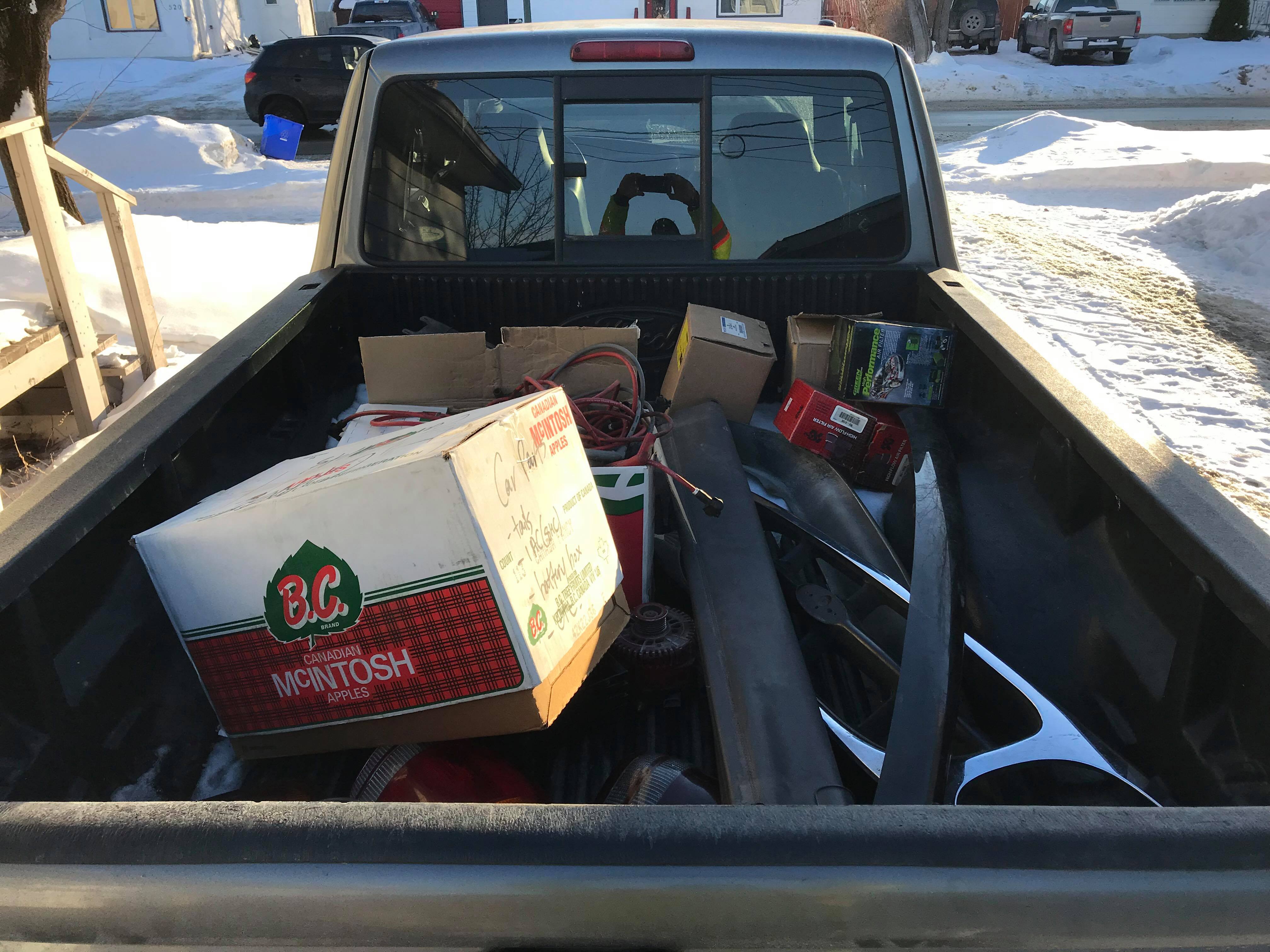

oh, and a idea of how many parts were in it?
theres still more. i have to go back and get the rest out of it. there was even parts in the cab of my ranger.

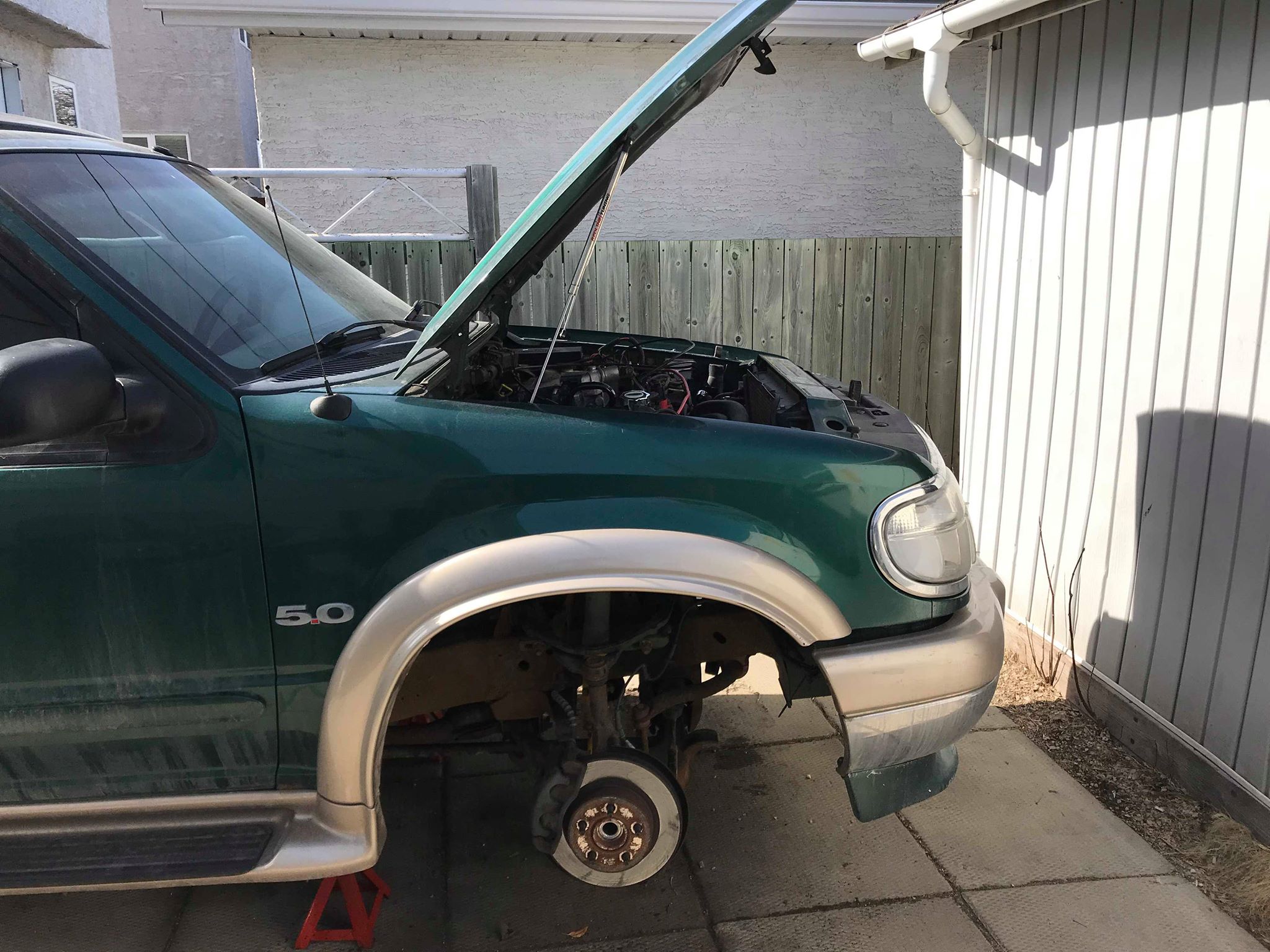

fast forward a month, old man winter has had his death grip on us up here in the great white cold north. me without a garage to work in has had to wait until the snow melted enough to bring the truck back to my house, and with evil sitting in the back yard shadowed the sun from also making that white crap go away. asked another friend if i could park it at his place while i work on "eddy". finally enough snow melted and home it came on a co workers trailer. forgot how bad the motor sounded. thought it was gong to seize up just driving it onto the trailer, but it made it
then work threw me a curveball and tossed me on a afternoon shift. so it sat until last weekend. lucky enough it was a toasty 2C (or 35F) for me to start on it
then thats when things on this project took a hard right, into the wall....

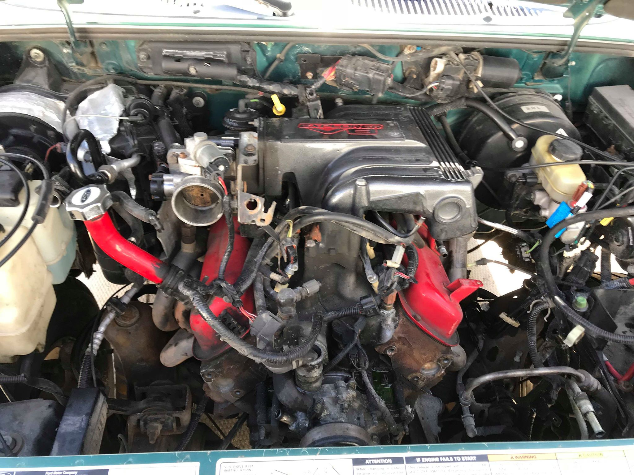

this thing has some fight in it. or stubborness if you like. the first wounder event happen when the top bolt head for the starter stripped because it was locked solid. out came the blue wrench for that because i was done asking it to budge. managed not to screw the starter up by some miracle.
the second was when i tried unbolt the trans cross member to tilt the trans down enough to get at the top bellhousing bolts. yea, those two were having no part of coming loose. they met their fate with a 1/2 angle grinder. anyone that has pulled one of these v8's knows all about that asshat of a bolt on the back of the head for the trans dipstick tube. it came loose, but only after using a 2 foot long bar on my ratchet which is really easy to use when your lying on your back with no room to maneuver, and with your blood pressure rising when the swivel on the end of the extension flys off and lands into the dark abyss. so finially with all the bolts out, and ready to pull, it had one more trick under its hood and that was the motor also locked to the trans. now, i have pulled lots of motors in my time, but never have i had this happen. i had to lift the motor up off the mounts just a tad, then place a jack and a block of wood under the bellhousing. then had to do the most brutal thing, and jack the motor up as high as it would go in the truck and nascar drop it back down....3 times before it seperated enough to get a bar in between the motor and trains, until....
VICTORY!!
so i was out in the shed till around 11:30 last night cleaning up the explosion of tools and swapping a few things from the old motor onto evils old 302. if i can find the correct bolts i need for the manifolds today (the TMH's wont be going back on, not letting them go with the truck as well as some other parts) i should be able to finish it up today, and if im real lucky, and motivated slip it back in where it will have a new name, evil eddy lol.

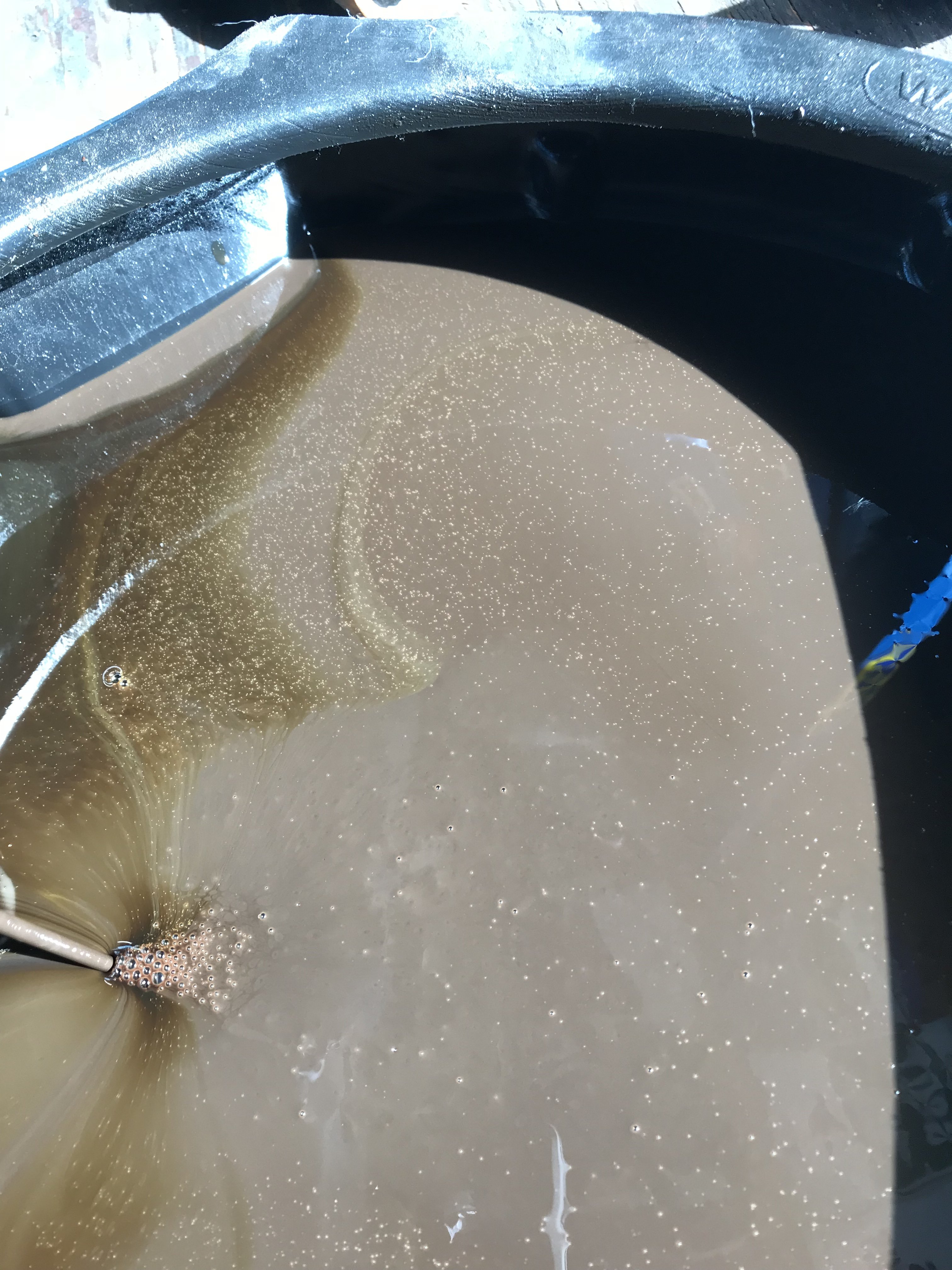

Speaking of color. Lots and LOTS of gold in there...
Aaaaand the reason for that would be
Can you say oil starvation children?
Wow that's pretty bad
