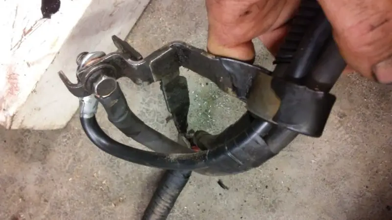

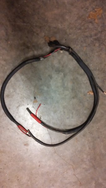

And i have been having one hell of a time with battery cables, while using those cheap-o battery terminals, the ones you cut and clamp the cable to the terminal. Mine were horribly corroded and when i would jump start the truck (shot used battery) the negitive able would start to glow LOL from high resistance.
So using the BIG 3G upgrade that the BKO guys do,i replaced the positive and negitive terminals with marine style stud clamps and upgraded all the main wires (minus the charge wire, I will do that one this weekend) with 0 gauge welding cable, and High Voltage/High Amperage cables and (thanks to @gmanpaint for showing be the cable clamp tool!) cable lugs.
Battery/Starter cables
Not liking the idea of cutting away a small section of insulation on the ground cable, to ground the frame, i replaced that section on cable with its own short section, the above lug will bolt to the frame, and then to the engine block where that factory bolt is.
You can see above the other end of the frame grounding cable and engine grounding cable. used the factory bolt and also the factory bolt "keeper" so if anyone does this upgrade try and save the little keeper to reuse.
Here is the starter side of the cable, starter power wire and the starter trigger.
my rig still has the factory setup at the starter solenoid and is still in good condition so i cut the start trigger wire about 6 inches from the solenoid and installed a WeatherPack connector.

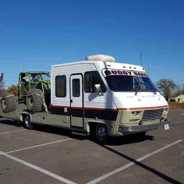

And if anyone is wondering what Gman is talking about with the Buggy-barge, I picked up this 27' 1983 Fleetwood Pace-Arrow last weekend. The buggy on the back is his, for referance those tires are 44x20
Since i dont have a "buggy" i renamed it the "Crawler Hauler"

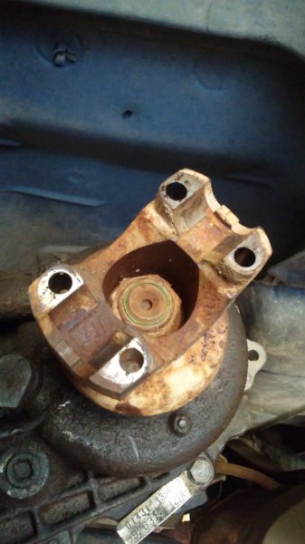

I went to the wrecking yard last weekend and pulled the front transfer case yoke (double carden) off of one of the explorers there, as the front and rear spline count is the same. Installing that (front) yoke on the rear will give me the ability to run a double carden 1310 joint on the rear of my rig.
Now if i can just find some info on finding the long side of the rear driveshaft with a slip yoke sleeve with a 32 spline count i would be completely set up on the rear driveshaft

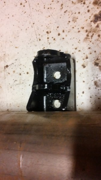

These are the lower shock mounts, I had already installed them and cut them off to clock the axle to point at this transfer case. the lower eyelet is turned so the eyelet can pivot with the axle during articulation.
To get a better idea of how it is mounted; That is a piece of 4 inch tube to reference the rear axle tube. The mounting bolt with be installed from the back and the nut slide between the bracket and axle tube,

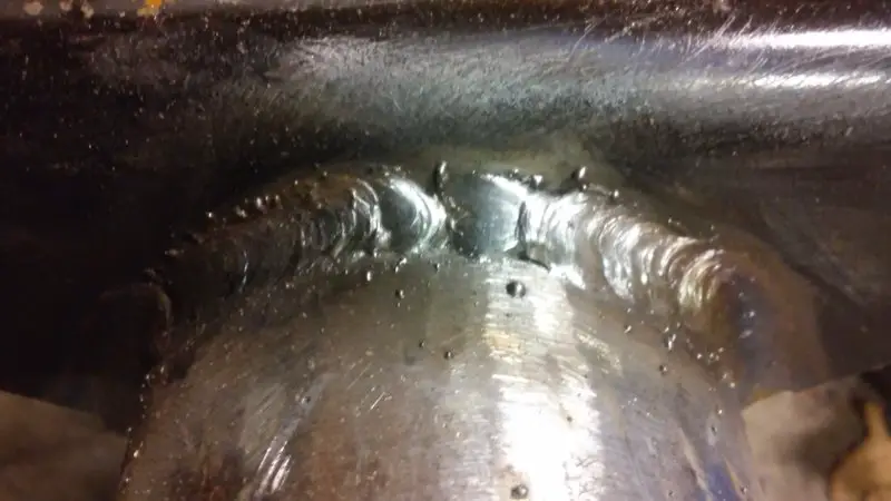

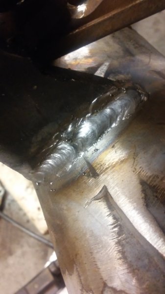

New spring perches welded up, i think my welds are getting better!
Weld on the lower shock mount.
Front transfer case yoke installed, allows you to run a double carden joint on the rear.

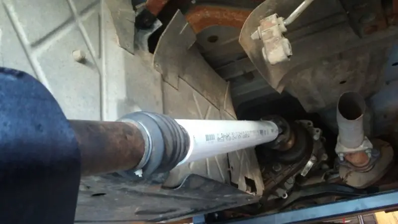

Sch 40 2" ID PVC for mock up, that piece in 2.250" long and the slip joint is a little too compressed so i think ill shorten it up a bit and check full compression and extension on the suspension and see how things fit.

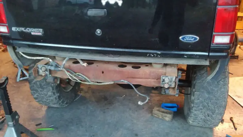

All instead of working on the Dana 44 like i should (cause i have all the parts!) I hate how to stock rear bump looked with everything else modified on the truck and with removing the rear tow hitch and hangs down really bad because of the 3 inch body lift so that was taken off and NO Recovery points.
so i started to fab up a simple rear bumper.

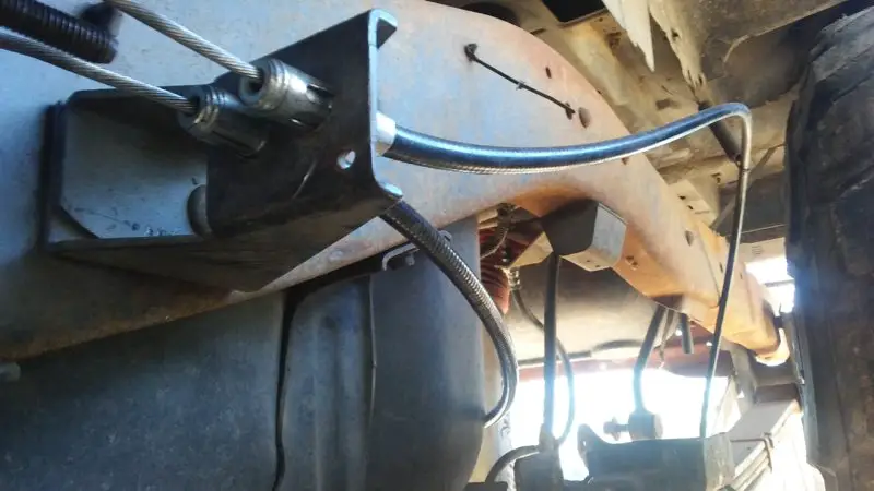

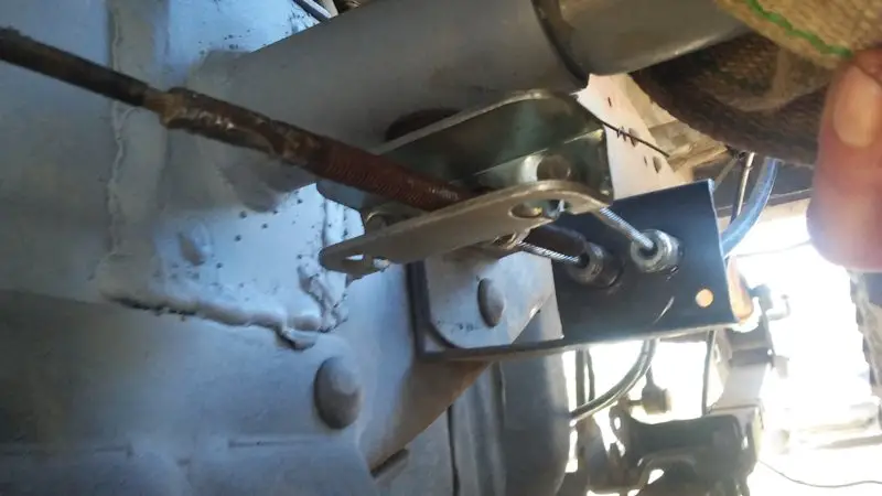

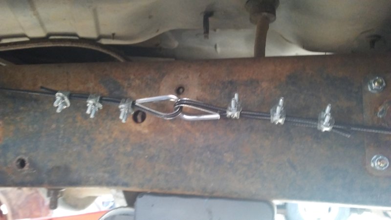

Ebrake cable is done

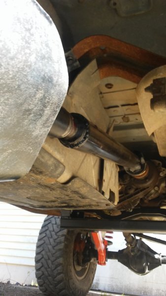

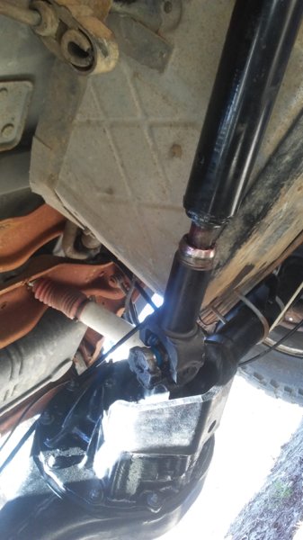

And the rear driveshaft works perfectly. Unfortunately I couldn't keep the rubber boot on the slip joint because with the boot fully compressed, I couldn't compress the driveshaft far enough to install it.

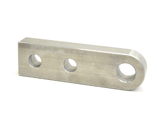

I am going to skip the SMORR meetup this weekend to get the To-Do list done on the Pearl. Thinking about the recovery points, i ordered a set of shackle mounts from Chassis Unlimited last night. 2 pounds EACH!
CNC Machined from 1" Thick 1018 Cold Rolled Steel -1" Thru Bore- Perfect for upto 7/8 Clevis Pins -2" Wide -Optional 3/4" Mounting Holes, for Bolting onto Frames ETC

Well i just got an email from Chassis Unlimited, The shackle mounts are back-ordered until next week. Guess i can be working on the other things before i jump on the bumper

Still bugs me that there isnt some kind of dust boot over the slip joint on the rear driveshaft. Talking to Gman, I have a few extra shock boots and i believe they will slide right over each end of the driveshaft.
Like a dummy i installed the rear ujoint backwards and cant access the zerk fitting, so when i pull the yoke off to spin the ujoint i am going to see how that boot fits over each end. I think it will work.

The shock boot will be better than nothing. They aren't as strong, but should last a while as long as they are clamped tight, and don't spin.
